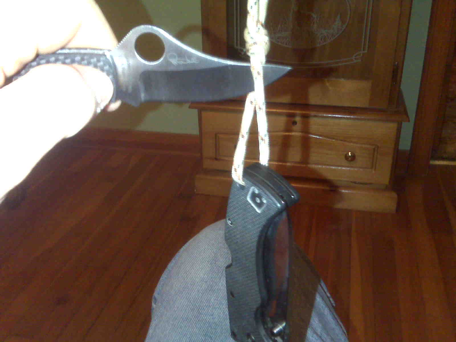

Heres a pic for all you T-Mag people The Deacon posted a pic of a T-Mag holding 9 pennys with the 10th one closeing the blade B U T after I put in the new N52 Magnets... well yall tell me what ya think oh and yes thats a Cold Steel American Lawman weighing 5.4 oz hope yall enjoy

So Spydercofanatic... this is with the two cube magnets, you say?
Do you think that they are an improvement over the original magnet worth to replace it with these new ones? If yes, I might order some of them! In fact, the original magnet seems to be quite weak compared to the N48 Magnets I purchased from a german/swiss dealer. I am quite confident that the two 1/4" N52 cube magnets would be significantly stronger.

yes Murdoc they are MORE than worth the $7 to put in Like I said in my post The Deacon had a pic of 9 pennys on the blade with the 10th being the one that closed the blade and now mine holds up my American Lawman LOL!!!!!!! and I also have a nice cut across my finger where she SLAMED shut on me :rolleyes: I promise you that you wont regret it. If you do I will buy the magnets from you so you can get your money back THATS how sure I am
