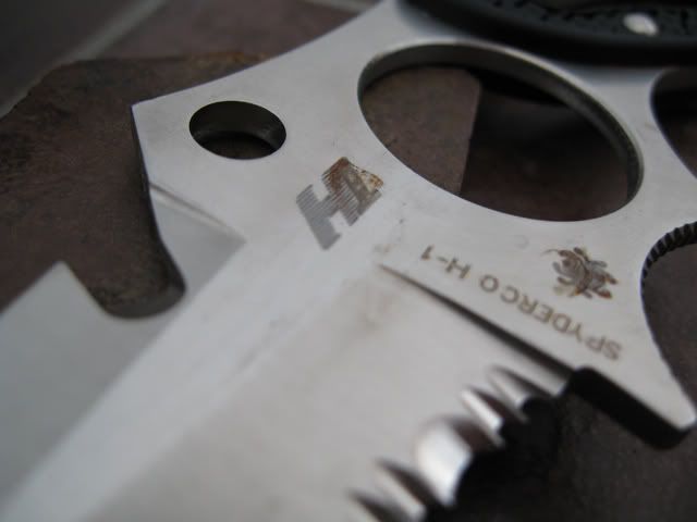

Sorry, but H1 is not impervious to rust.Slatts wrote:I think it's a bit much to expect to leave any knife blade exposed to the elements without some rust. But then again, I haven't tried H-1 yet.
Here's my Caspian after its first exposure to sea water.
I purposely left it unwashed over night to see what would happen. The rust occurred over the logos, but not exclusively over them. Also, this was the side up against the back of the sheath where the water was trapped against the blade.

That's definitely rust, but I'd be it's not the H-1 that has rusted. There have been a number of previous reports of simliar rust in the areas of the logos on H-1 knives. The general consensus is that it's the result of small particles of other steel that were deposited on the knife during the polishing process. You should be able to remove them with minimal effort and there should be no marks left on the knife afterward. In this case, the shape of them almost makes me wonder if they're from rivets in the sheath, or some other external source.

Actually, it is. Deacon is exactly right - there might be rust present, but it is something else that is rusting, not the H-1.StSumwhere wrote:Sorry, but H1 is not impervious to rust.![]()
