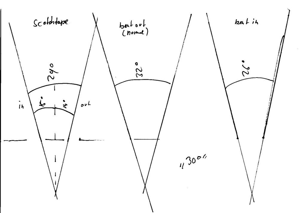

Well, I just measured exactly the angles on my sharpmaker...something I always wanted to do anyways... that's the scientist in me... :-)
I used the white rods.
result:
30° setting:
bent out (normal angle when sharpening): 32° incl.
bent in max: 26° incl.
taped: 29° incl. with 15° inner rod, 14° outer rod
(I just KNEW that!! That's why I have to tilt the blade a bit when sharpening the "right" side to get to the actual edge (as revealed by the 'magic marker trick')!
40° setting:
bent out (normal angle when sharpening): 42° incl.
bent in max: 36° incl.
taped: 39° incl. with 20° inner rod, 19° outer rod.
Just wanted to share.
Dennis
Murdoc
Posts: 1227
Joined: Fri Jan 05, 2007 1:54 am
Location: Koblenz, Germany
Post by Murdoc »
That's how it looks :)
