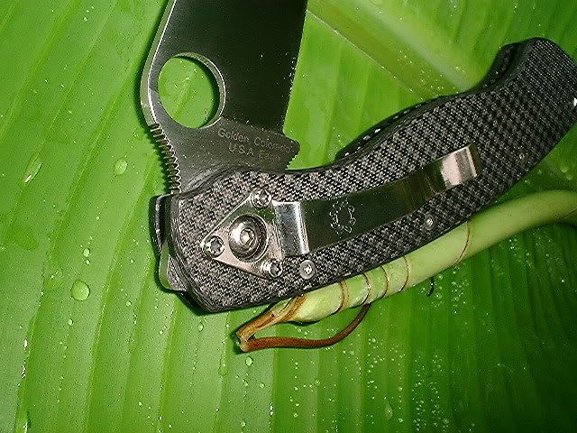

Here's a few pic's of the delica clip i just did with my dremel. It turned out good enough for an edc.
