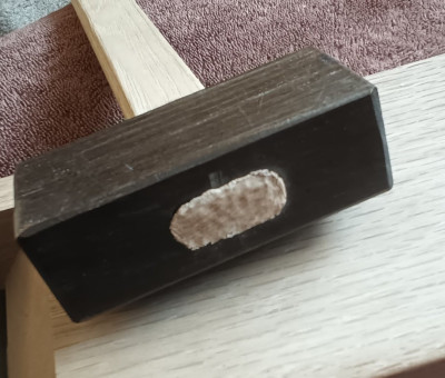

Reminds me of a story I read about Japanese , hand made , high end, woodworking plane blades (see image below) .
The story goes that once the dudes (Shikonin / Master woodworker) used a new plane blade if it tended to chip they experimented with sharpening bevel angles and if it still chipped they would pick a particularly hot day and put the blade on the roof (often a metal roof) and some times after that the blade would be a touch less hard .
The Japanese hand plane is a masterpiece of simplicity AND precision (read up on how the bottom of the plane sole is "shaped and tuned" . It is not flat but it looks flat .
A few taps of that mallet can advance or retract the edge predictably to < a thousandth of an inch .
Along with the plane adjusting mallet I made from hickory for the handle and Lignum Vitae for the head ; no wedge to hold the head on . I used the Windsor chair technique . . . bake the handle ultra dry , inside of head is tapered , install handle in head , apply a bit of moisture and while damp I "peened" the protruding fibers to a mushroom . The handle swells , mostly from ambient humidity , and when in balance again it fits the head perfectly and VERY tightly . The other part of that is the other component of the joint , that would be the head in this case would be wet / undried wood . This Lignum Vitae is so hard and dense AND naturally OILY that it won't absorb much water once dry . ((fun fact ; it is so dense it will sink to the bottom of a bath tub and lay there / won't float)) .
Windsor chairs last 300 years without getting rickety with no glue or fasteners . Little known fact .
