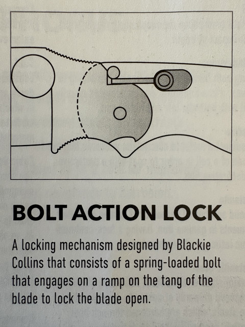

Anyone have a good pic of the bolt action lock they could share? I don't know that I've ever seen a Spydie with that action.

I *think* it only came on the Sage 3?
I wonder if Sal could elaborate on Spyderco's history/use of the bolt action lock and if there could be plans to do anything more with it? The one time I used one, I liked it better than any CBBL (even though both are great), so I'm curious if there is any hesitation or barrier for using one further.

Re: My dream Spyderco....
From the catalog…
Here is a review, showing the internals:
https://morethanjustsurviving.com/spyde ... fe-review/
Imagine in the Native came with one!
