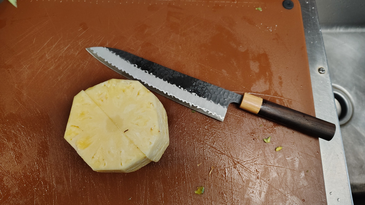

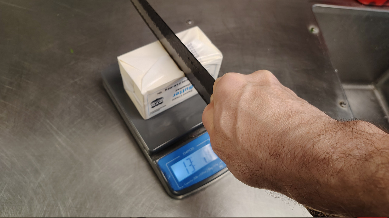

Well the direction this thread has gone has me curious about two things.
1. Who makes a cpm3V machete.
Looks like the only one that popped up on a quick 2 minute search was a $450 cold steel kukri machete. Maybe I'll finally pull the trigger on a 3V trail master instead since those are $250 and big enough to use like a short machete.
2. What other completely mundane every day things we cut that take over 12lbs of force.
Add halving pineapple to the list
13.5# using straight downward pressure with a 2mm stock 9dps shaving sharp gyuto.
