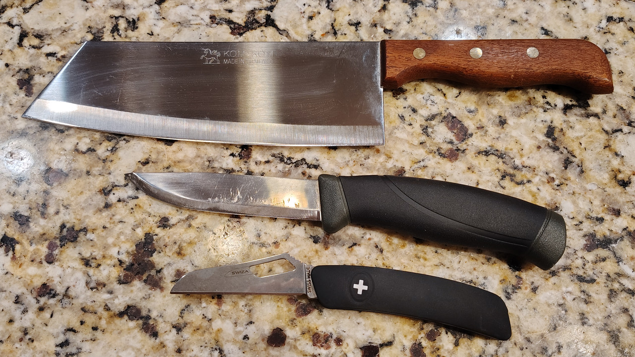

In fact here are three examples from my own collection of knives that ship with geometry that's as thin or thinner than a typical serrated Spyderco:
Kom Kom chef knife, Mora Companion, Swiza locking floral knife.
The Kom Kom is 1mm stock with an estimated 9dps factory apex, V grind.
The Mora is their classic scandi grind ground at 11.5 dps according to their website. This one has been sharpened so there is no microbevel. It routinely carves knotty wood and even baton wood for kindling without edge failure.
The Swiza is their liner lock floral knife, ground at an estimated 21 degrees inclusive, chisel ground.
All three work great for on a variety of materials. The Kom Kom has just been used on food but as you'll see it cuts cardboard without issue. The Mora does bushcraft stuff which can be hard use at times. The Swiza I use for general utility like cardboard, rope, and breaking down plastics for recycling.

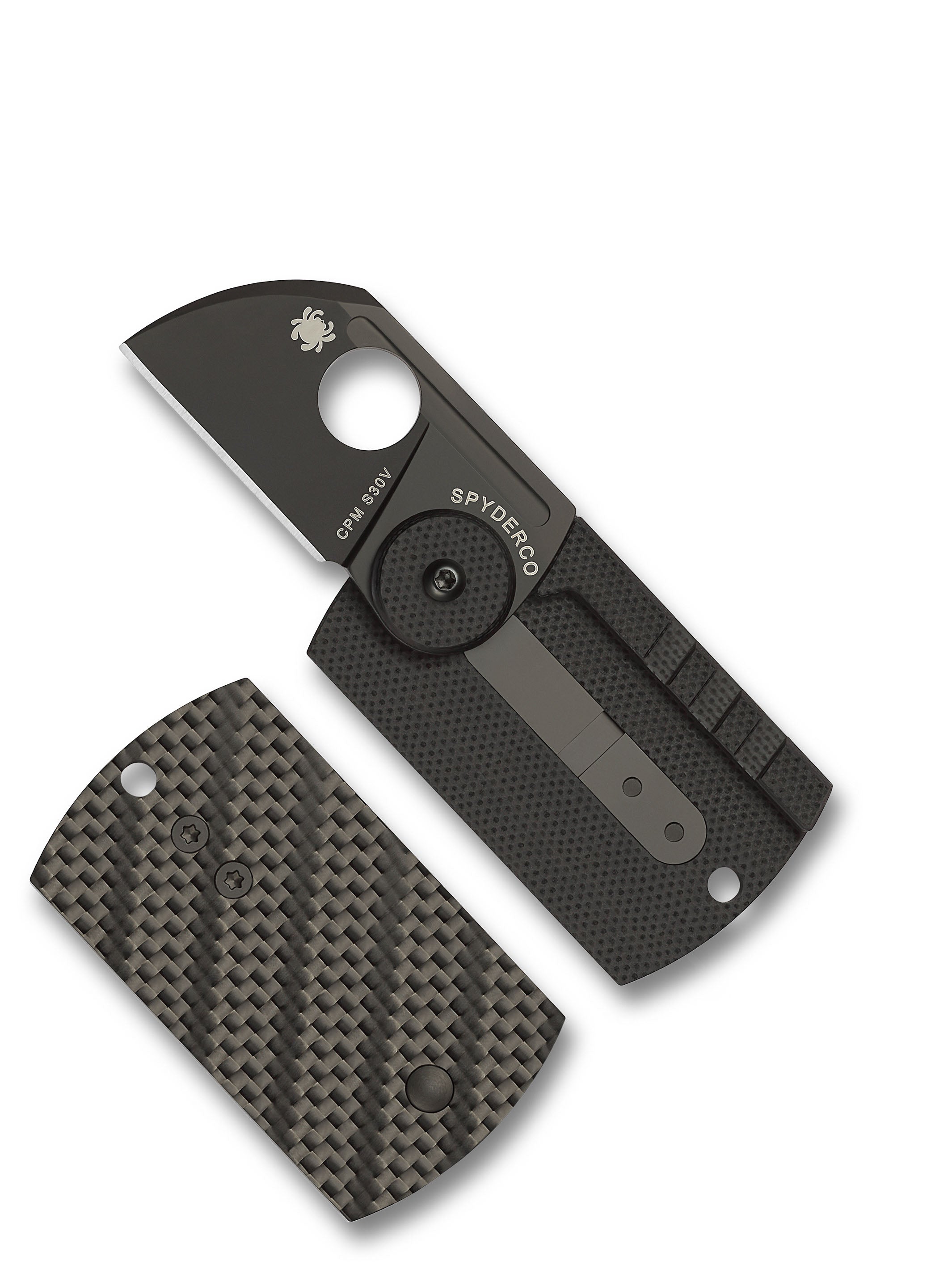

Did a little research and it seems Spyderco currently offers chisel ground plain edged blades themselves.
I don't own one but it appears it'd be in the 20 degree inclusive ballpark, using a steel with a reputation as being chippy (I've never had an issue with S30V personally).
Now, why do they make this particular knife ground so thin compared to other small, lighter use knives like the Ladybug, Grasshopper, etc?
No clue, but it shows even Spyderco is willing to mass produce plain edged knives with edge angles as thin as their serrated knives.
