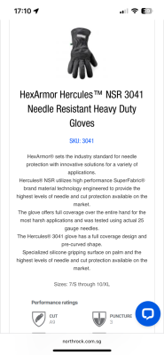

I’m not sure what ‘fu fu’ means (got some pretty varied google results 😂), but we’re not working on domestic properties - the landscaping we do is growing tropical wildlife reserves and rewilding existing green spaces using Syntropic Regenerative Agricultural tenets. We get some pretty epic thorns over here too, but they’re not normally low down so less of an issue than what it sounds like you’re having to contend with. We wear needle and cut resistant cut gloves on our off hands when using machetes, as much for protection from the ever present risk of pit vipers, Cobras, jungle ants and giant centipedes who all love to chill in the long brush as for the swung blades. My personal favourites are these as they have great grip on the interior and aren’t too sweaty or spendy (we get through a lot of them over the course of a year, and unfortunately they don’t sell left hand gloves individually so there’s a lot of leftover right hand gloves 🫠) -
I agree, string trimmers are a chore to use around fixed objects, especially poles. We get around this (no pun intended) on young saplings by resting the edge of the string guard on the pole and walking a circle while keeping it pressed up against. Stops the string hitting anything but brush, although we don’t do fence poles with fence attached as we don’t have any fences on our sites, so this is probably not practical for you. Would a controlled burn work? We’ve had good results around building edges and man made paths using a gas burner setup and basically blanching the brush just to the point where it wilts rather than sets on fire. Anyways, I’m not trying to tell you how to suck eggs buddy or virtue signal, just trying to help a brother. I’ll happily mail you a set of these gloves if you want to try a pair, just PM me 👍🏻 They were a game changer for us and are really nice quality.
Back to the subject of a Spyderco machete - I’m game for anything that doesn’t rust and/or suck at cutting things for protracted periods. I have Cruwear and 3V and it doesn’t love the high humidity of the tropics (in fairness very few steels handle the environment here, even VG10, S30V, etc all rust in the pocket over a day), but Magnacut or LC200N would be fantastic 👌🏻
Also, YES to a Rock Salt sprint 🤤

Oh, cool sounding glove... and thanks for the gracious offer to send my sorry hide a pair, but I can check into them.
