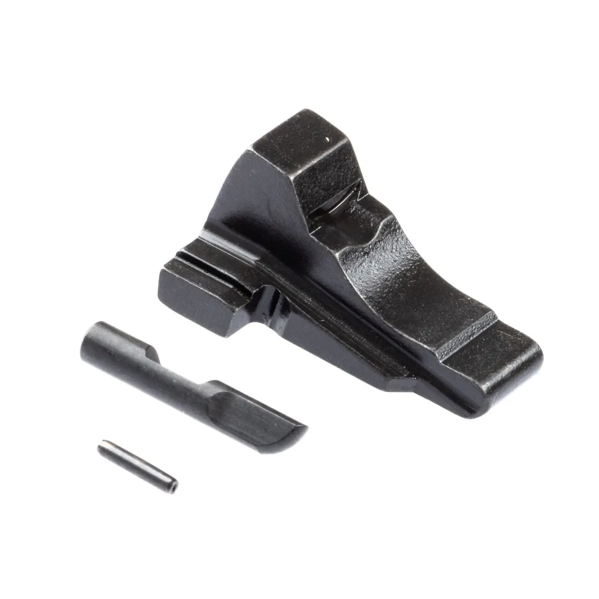

Years ago the Beretta 92 started having issues on a part called a locking block. Each side had an inside angle that was machined to a sharp 90 degrees. During normal operation of the pistol the stresses were concentrated there and the "ears" of the blocks could crack. Beretta's answer was to radius the inside corner on each side rather than leaving it at a 90 degree angle. That radius is barely visible on the bottom edge of the larger part in this picture. (It's in the corner of the "L" shaped angle.)Naperville wrote: ↑Mon Oct 20, 2025 5:28 amIt is well known within the Corvette community that if a crack appears in a fiberglass body panel that you drill a hole at the crack tip and it distributes the stress to stop the crack.

Hey Pokey, are you a fellow Beretta lover?
