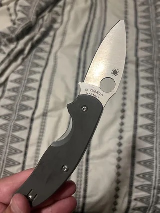

Posts: 6064
Re: Is Maxamet from Taiwan "better" than from USA?
#37
Taiwan Maxamet Sage - Broken Tip.
Why can't the Taiwanese make a better screwdriver than this?
