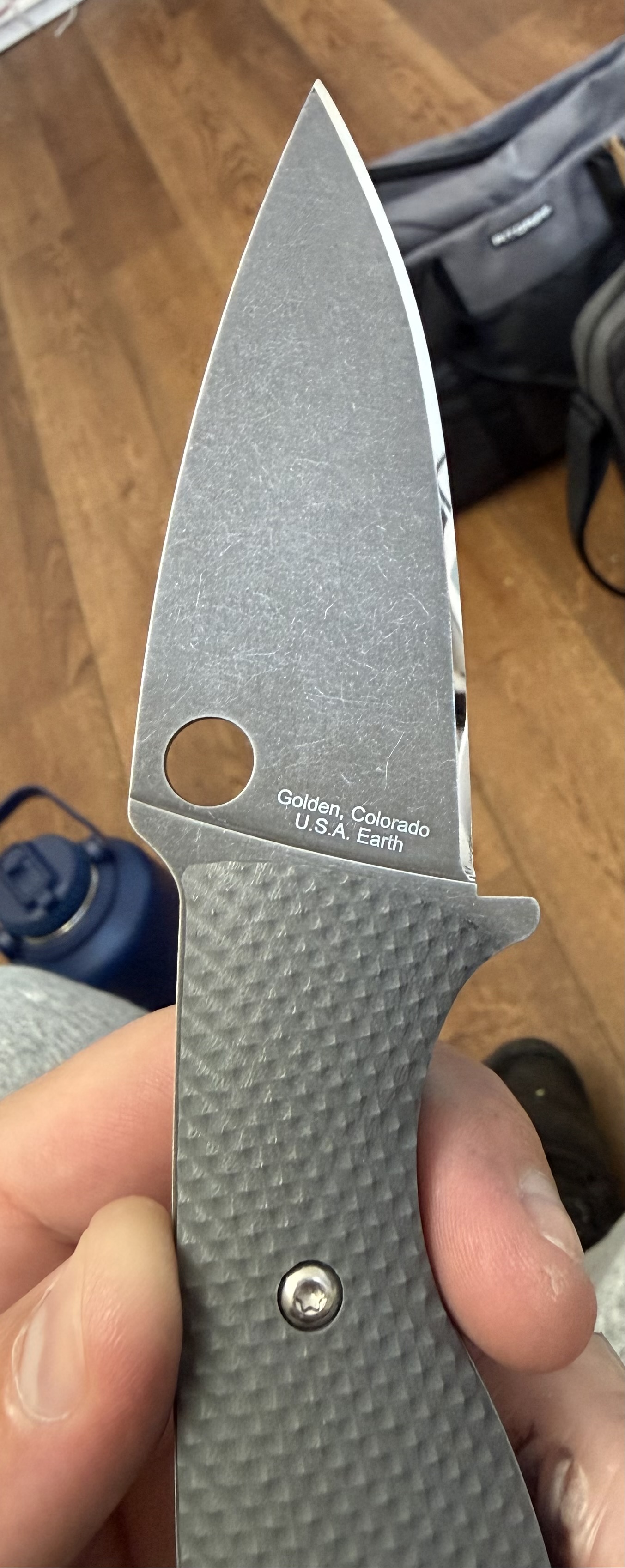

Post by Jayrod1980 »
Love this knife! Cuts great. I ended up marring the finish a bit so I decided to go acid stonewash. I cannot wait until this steel is in the regular lineup. I’ll probably sell half of my 40 something knives when it happens outside of my 15V collection.
I didn’t state it in my last post but I took the mule to 15 degrees each side with a 3000 grit edge on the WorkSharp. I’ll never sell this knife… first production Magnamax blades ever will be gifted to my son when I pass!

Jayrod1980 wrote:
Sun Oct 05, 2025 8:03 pm
Wow! That’s one good looking knife 👏 👊
