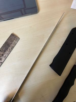

I cut my serrations into just one side in an attempt to emulate Spyderco’s chisel grind SE. The Machete in question is just flat bar stock with a sharpened edge though, so it’s ended up being a proper chisel grind almost by accident (I took the teeth way up into the blade to get nice scallops). The two duplicate 18inch machetes I’ve ordered to do a like for like PE to SE are a similar design but in the more Latin/Parang style. I’ll update with pics and whatnot once they arrive and I’ve SE ground one of them. I’ll also provide SE tooth to tooth, scallop depth and sharpening angle measurements.
On a side note I decided to try out a Skrama 240 at work against the Silky Nata (similar sort of designs but with a few pro’s and cons each way). I’ll do a group test at some point in the near future with the whole lot - SE, PE, choppers and machetes for a broader frame of reference.

Oh, and the Chisel cut SE thus far has not caused any directional bias in the cuts, but it is fully flat 2mm blade stock so that may vary on other machetes with different grinds.

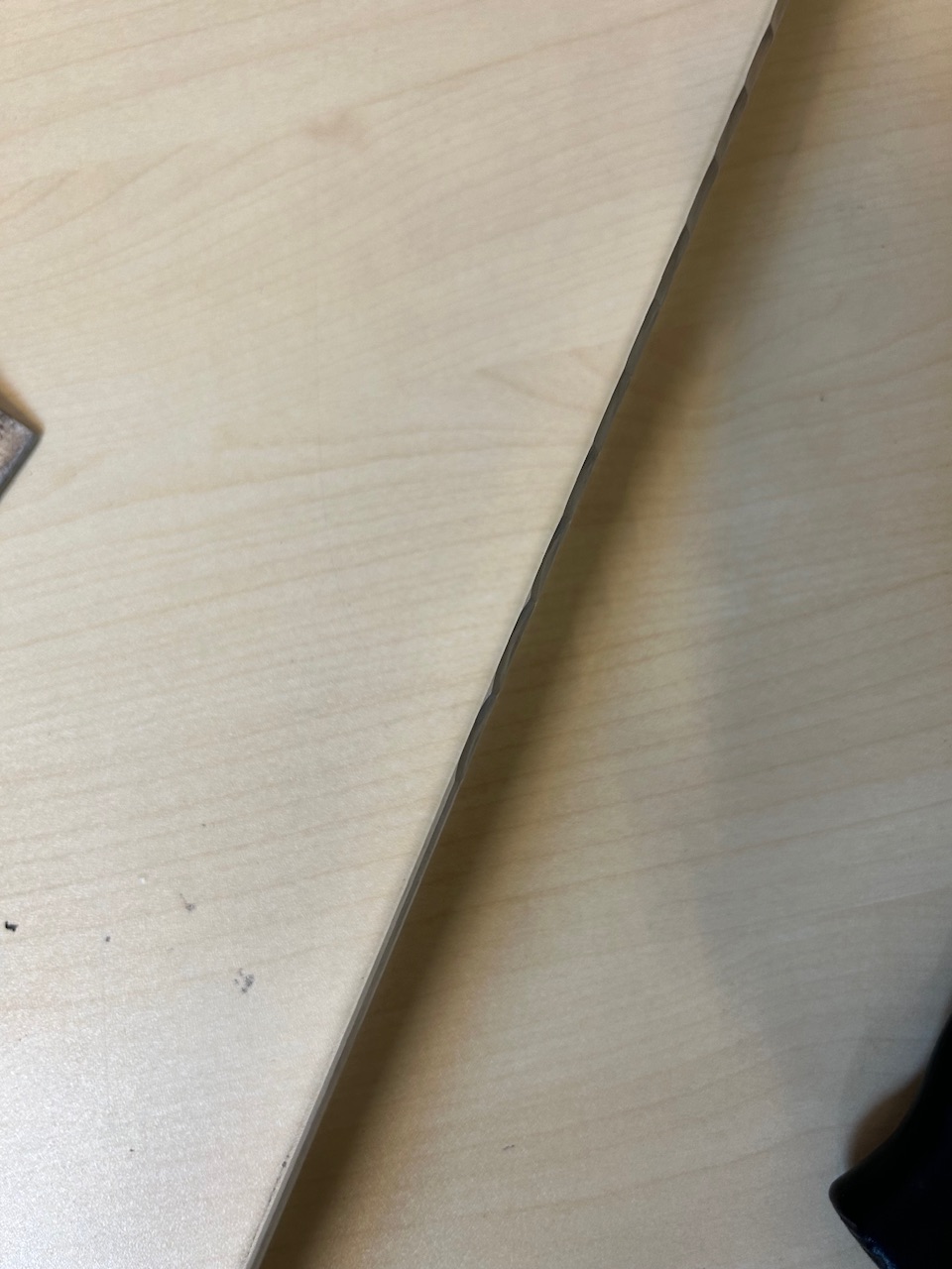

A few pics of the current flat stock SE and its chisel ground teeth, and a few for comparison with the Nata and Skrama choppers.
The choppers hit much harder, but the machete hits faster (as one might expect). For soft stuff I prefer the machete, but for harder wood I prefer a chopper or a saw. I generally have immediate access to knives, machetes, choppers, axes, saws and chainsaws, so I just pick my preferred tool for the job - a far cry from the ‘one tool for all things’ approach that many people choose a machete for, so I appreciate as an end user even though I use them a lot I’m an outlier for use cases.

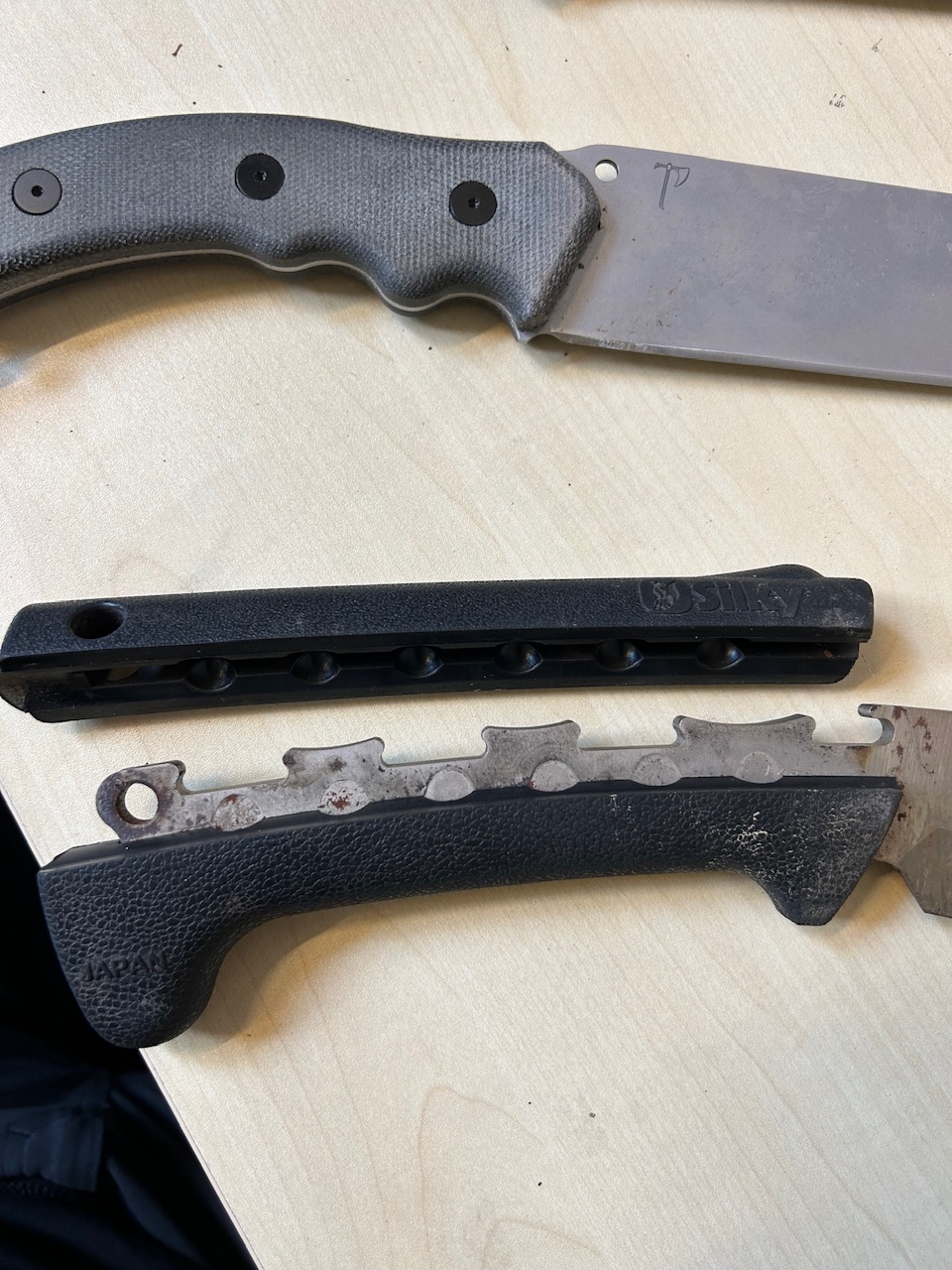

As for handles the neutral Silky 2 part one at the bottom is by far and away the most comfortable in use. The micarta and full tang on the middle one transfers a tremendous amount of shock into the hand even in softer materials like thick banana palms, and the lack of hook makes a wrist lanyard essential. The Skrama at the top is nice and the rubber compound feels extremely durable, but the contouring doesn’t match how I want to grip it choked up and the straight transition into the blade (unlike the silky’s negative angle) feels less natural in use.
- Al

For those that were wondering if the removable Silky handle would stay put on a machete - they most definitely do (I have the Silky Yoki billhook machete with the same handle design). The jigsaw shaped protrusions firmly lock into the rubber handle part. It is a wonderfully simply yet highly effective design.
- Al

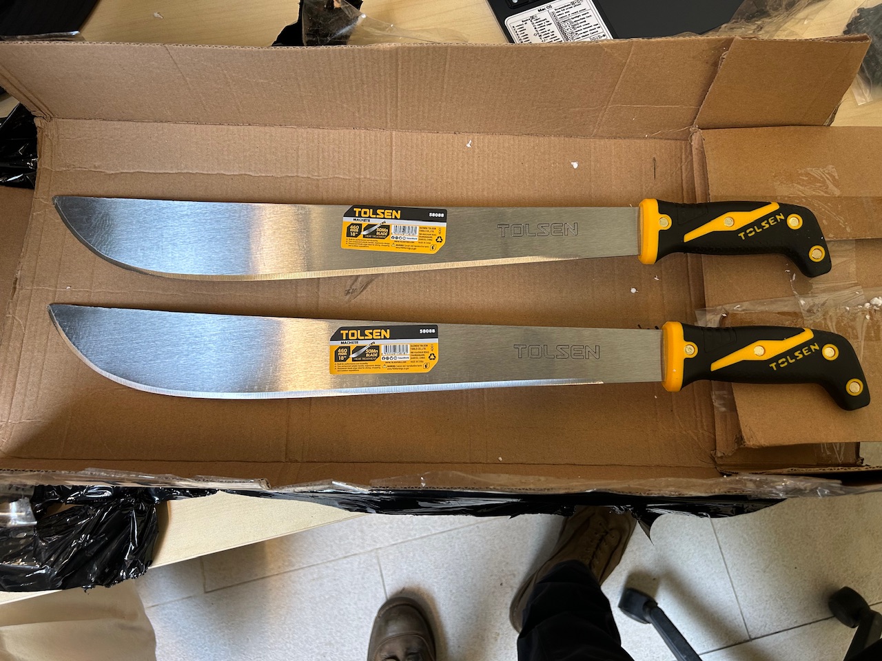

These two test…erm…donkeys… have just arrived. I’d call them mules but seeing as how they’ve arrived impressively blunt and with minor edge damage I’m loath to put them in the same category as a Spyderco mule 🫠
Whimsy aside, their vital statistics are -
- 18 inch blade
- 16 inches of sharpened edge
- 50Mn steel with some sort of heat treatment
- 2mm flat blade stock
- 24 degrees inclusive primary edge grind (12 per side)
They are tip heavy but overall very light for their size at ~500gms each.
Serrations inbound on one of them.
- Al

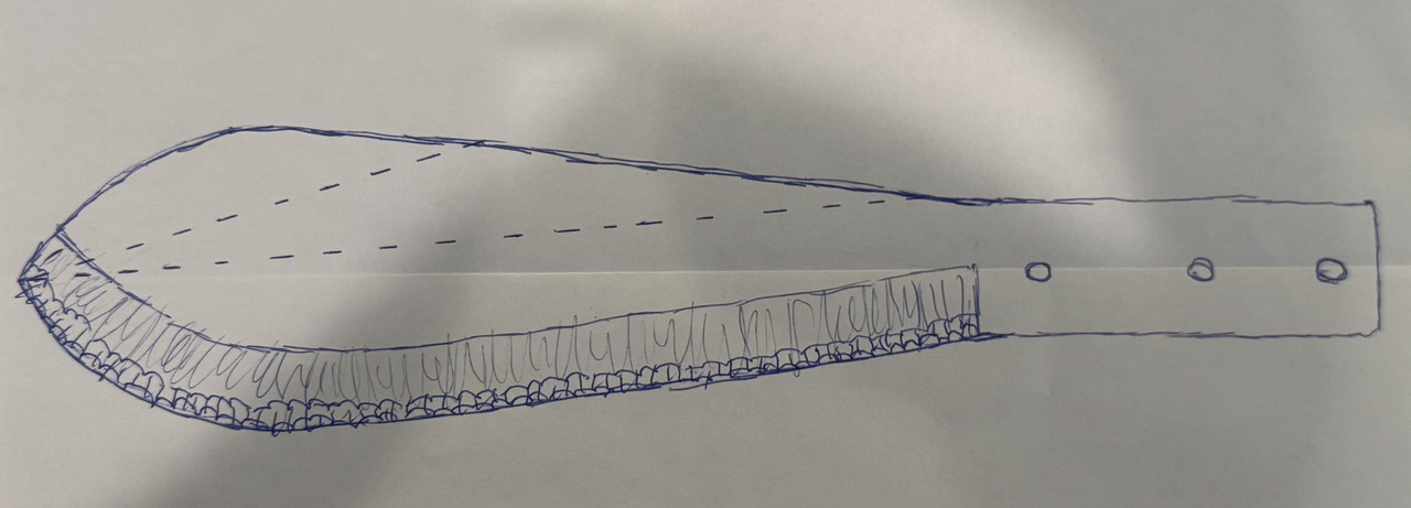

Condensed the length about 25% but you can see that this shape leaves little waste in cutting out blanks when alternated orientation. From this one shape you could make a few variations of blade design that could be modded if this was a “mule” from a straight edge to a kukri style and it could be a chopper with all that forward weight or be made into a light and nimble machete. You could leave the other side 90 degrees or sharpen it. Heck, you could cut in speed holes or make it a filet knife! This would be the most versatile mule shape imho. YMMV
Looks good! Might be a bit longer, but yea, why not! I'll get to try out my sharpening tools, and I might have to buy a cheap belt sander.

I would use a cut off wheel on an angle grinder to get the desired rough shape. Just need to take breaks and cool the blade in water. In an hour you could rough shape and belt sand it to a desired balance and shape.
