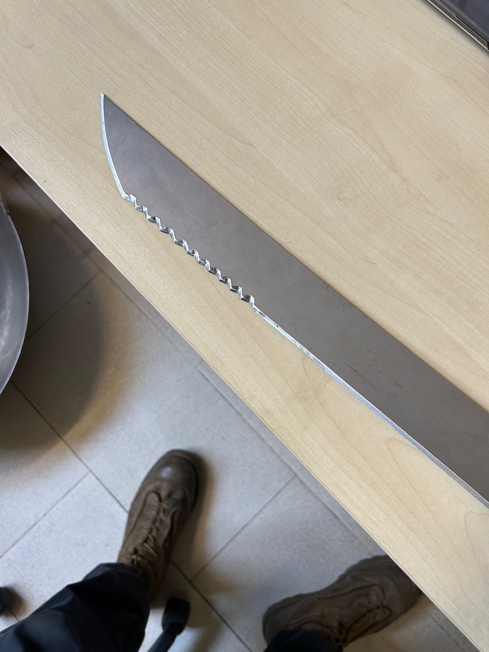

Ive decided to put my money where my mouth is and put some serrations one of my machetes. I figured it’s time to test my theory that one would be highly effective. The old Mk1 eyeball was employed on the first iteration of serrations.
I’ll pretty them up and make them progressively more Seki and less Taichung as I go along, to see if their pointy-ness affects initial bite and energy transfer. Once it’s done and I’ve tested it a bit I’d like to send it over to @vivi to get his hot take (if you’re keen Vivi?).
I figure if I hope Spyderco to one day make a serrated machete,, the least I can do is take the first step in proving one viable.

I'd definitely be willing to put one up against a coarse edged PE machete to see how viable the idea is, I just hate to think what shipping would cost you.
Great 👍🏻
Shipping from SG to the USA is surprisingly reasonable. I send all manner of ported chainsaw stuff to folk over there and it’s always less than I expect (within reason).
