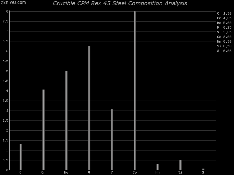

Post by Spyderfreek »
Rex 45. The fine grain structure and extremely high hardness gives it a very long lasting super scary edge in my experience. Rex 45 is pretty much all fine edge.
LazyOutdoorsman
Posts: 49
Joined: Sat Aug 02, 2025 6:55 pm
Re: What is the best steel for retaining high sharpness?
Post by LazyOutdoorsman »
Spyderfreek wrote:
Wed Sep 10, 2025 6:24 pm
I have heard of rex 45 holding a good edge for a long time before, but only once. Have you used hap40 before? composition wise, they look very similar.
Data from zknives
Too bad spyderco doesn't sell rex 45 or hap40 knives anymore as far as I know
