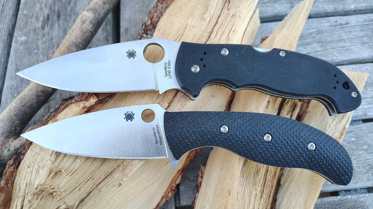

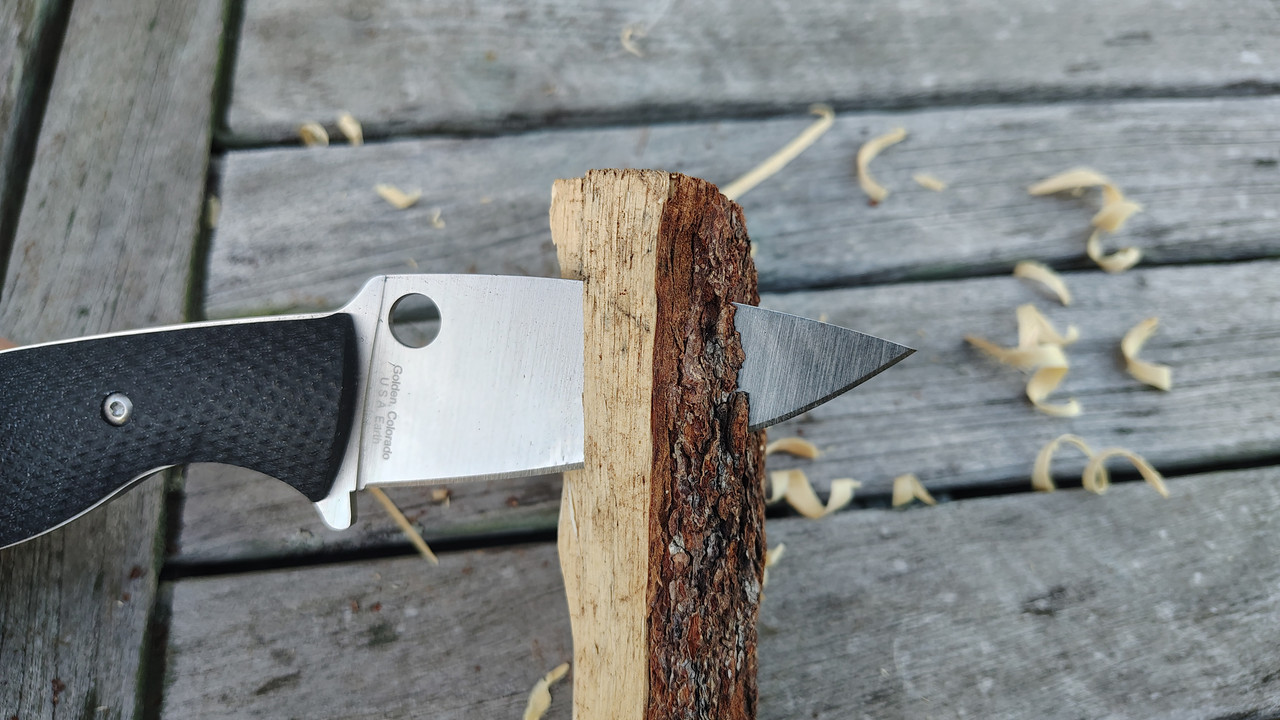

I got surprised with a magnamax Mule in the mail, so figured I'd start a thread for the performance of this steel.

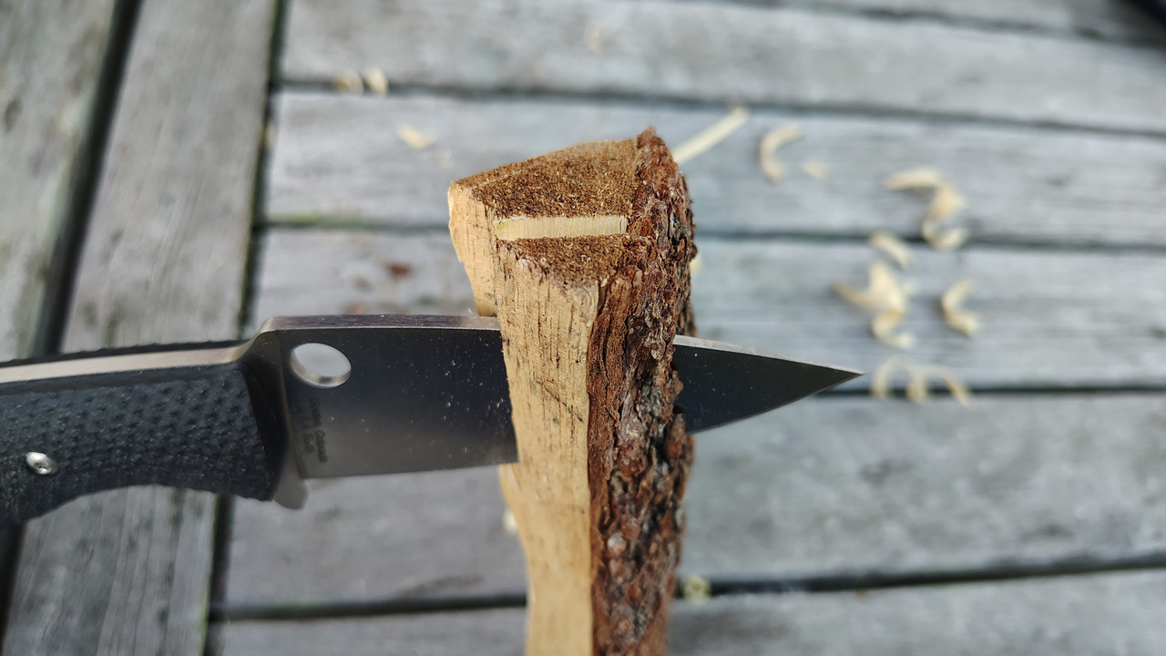

I started out by carving a bit of scrap wood in my burn pile.
The Mule appeared to have a fresh factory edge when I received it. It scrape shaved just fine,but didn't quite pop arm hairs, so maybe it had seen a little use.
Anyways, the edge and sharpness showed zero change from 20 minutes of making some shavings and feathersticks with the scrap. Did some light prying on some of the cuts, and a lightly batoned it through some seasoned wood a few times.
So far so good.
Planning to keep working with the factory edge angle for now. Think I'll touch it up on some stock medium rods on the sharpmaker, seeing if the 15 degree slots hit the apex, and if not I'll use the 20 degree slots. Then I want to see how much cardboard it can go through before the edge starts to degrade.

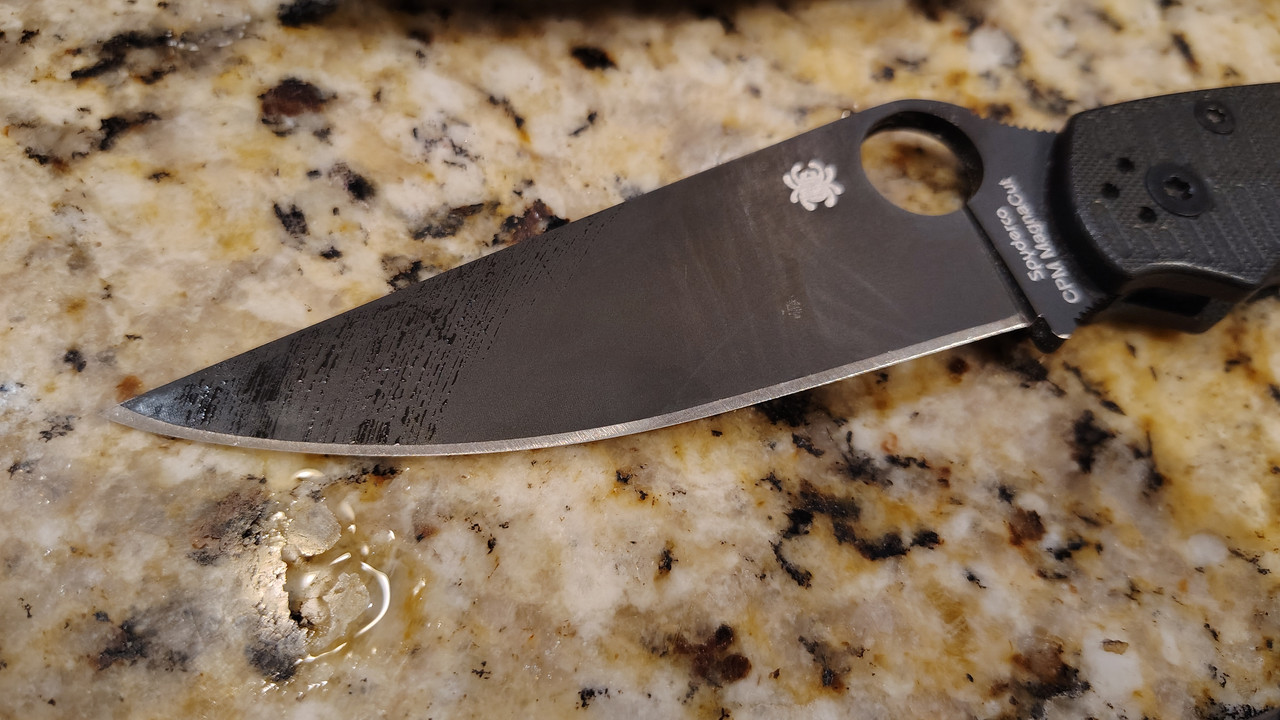

Next I want to test out the corrosion resistance. Unfortunately I only have DLC magnacut, but I was thinking about submerging this blade and my Military 2 in a salt water mixture and observing any changes. Figured I'd start with an overnight soak and repeat as needed until I see some sort of corrosion on either steel.

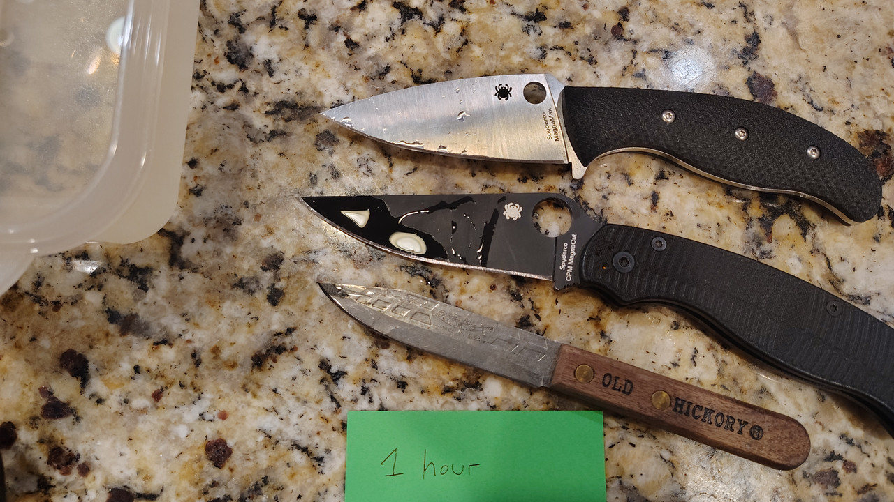

started the corrosion test.

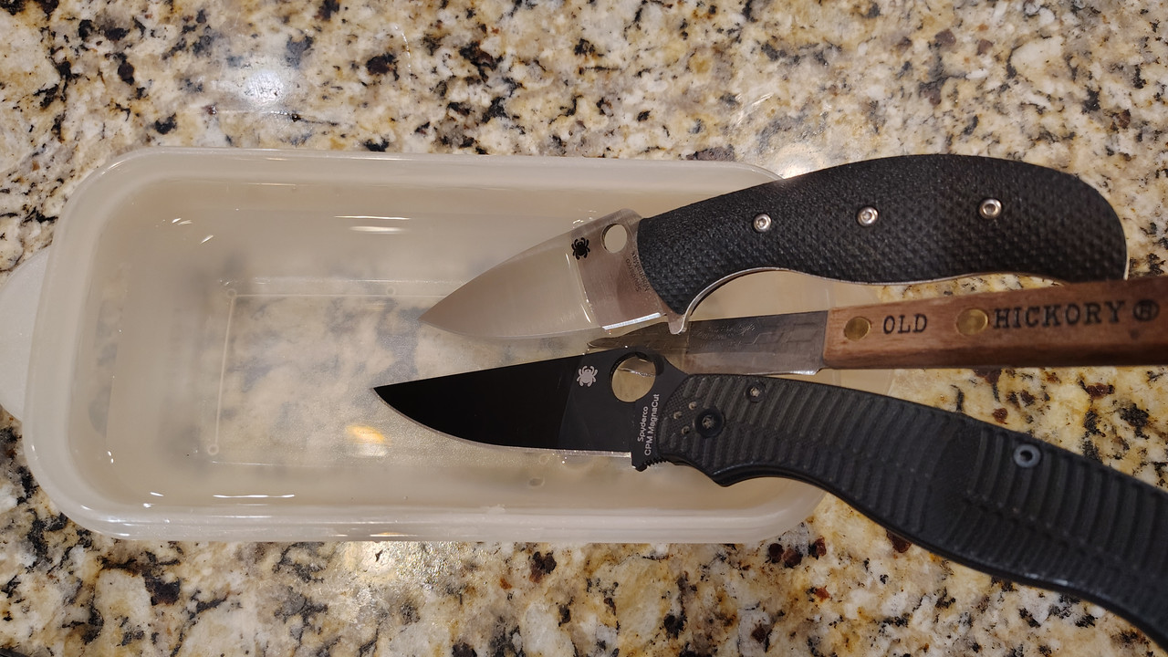

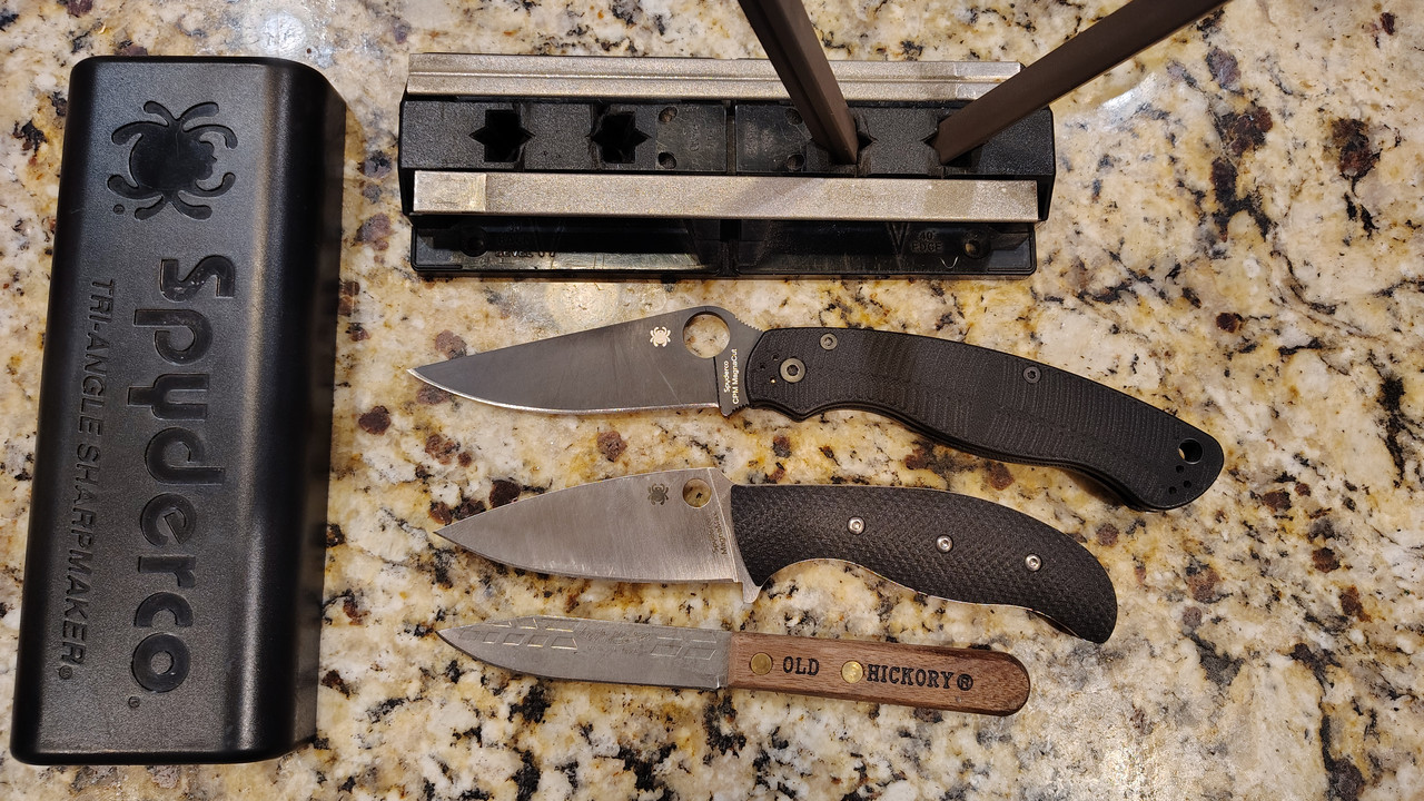

I took three knives and gave them a few passes on the sharpmaker brown rods until they each cleanly shaved. This way I can see how much the edge degrades instead of simply checking the surfaces for spotting.
Magnacut DLC Military 2
Magnamax Mule
Ontario paring knife (1095 to the best of my knowledge)
Next I had my kid make us a salt water mixture. 3 cups warm water, one tablespoon salt, stirred until the salt dissolved.
Will check it out every hour until bed time, then most likely leave them all over night.

no change in either spyderco after an hour

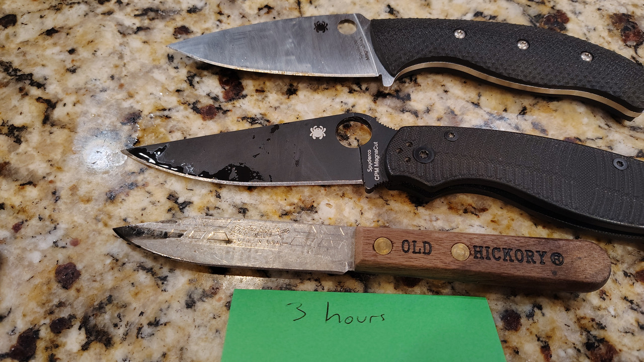

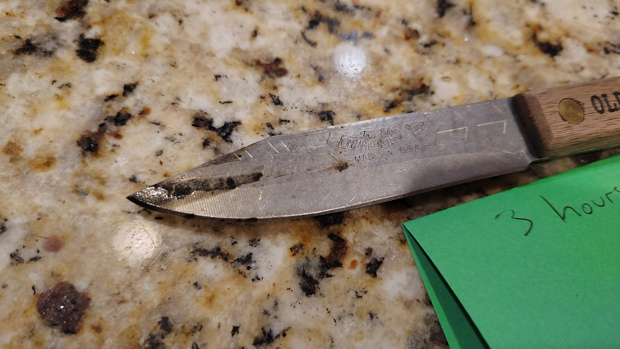

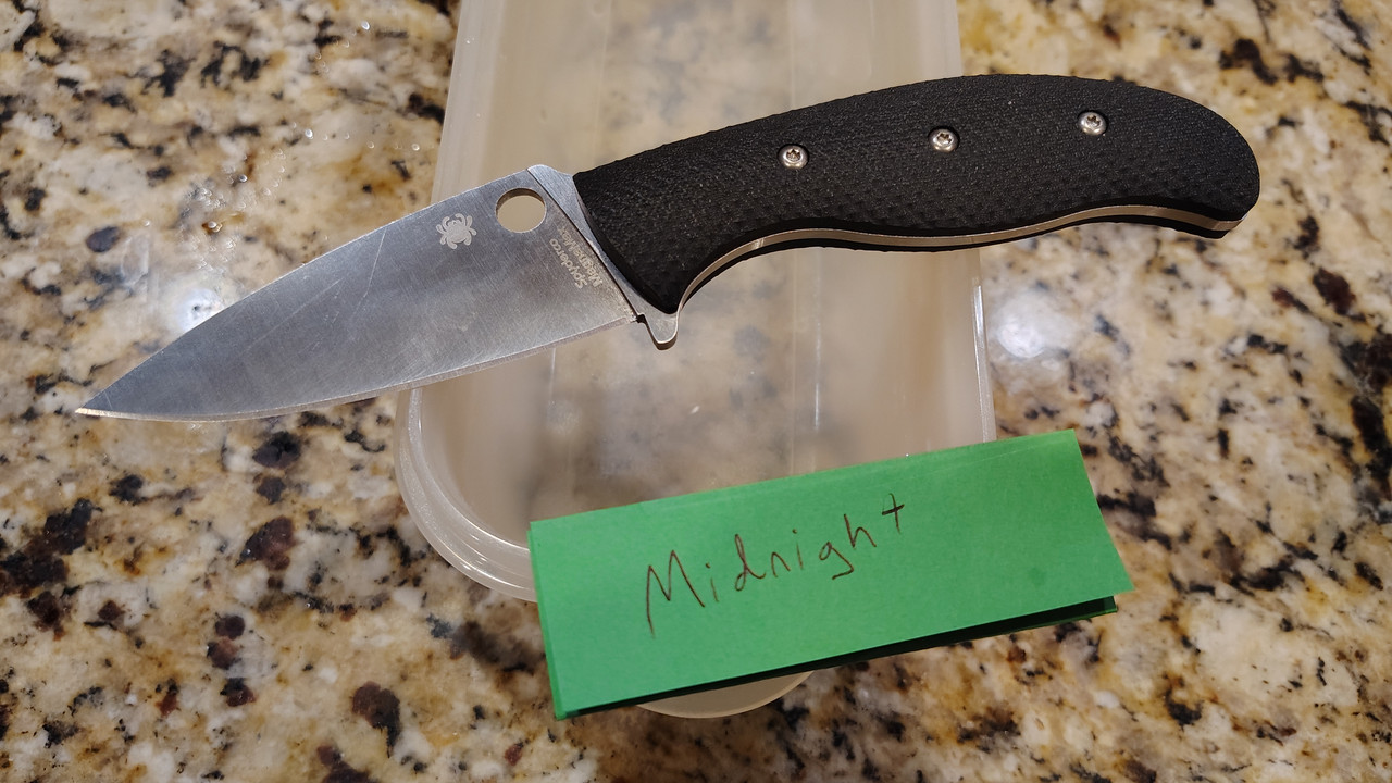

Well here's the corrosiom results after three hours.
As you can see, the magnamax mule rusted along the edge, and the Ontario got a good bit of dark rust on it, while the Military 2 is spotless.
The edge was still sharp enough to shave, and the more polished primary grind of the blade still looked spotless.
Now something I thought about is having the carbon steel in the same salt water bath as the mule might skew the results.
So the next step is to polish off the rust with bar keepers friend if a wet rag isn't enough to remove it, then repeat the test overnight with a new container and new mix.
Based on these results it doesn't look like a salt worthy steel.
That said, taking 2-3 hours submerged in salt water to show this small amount of corrosion is by no means a poor level of corrosion resistance, especially if edge holding really is on par with K390.

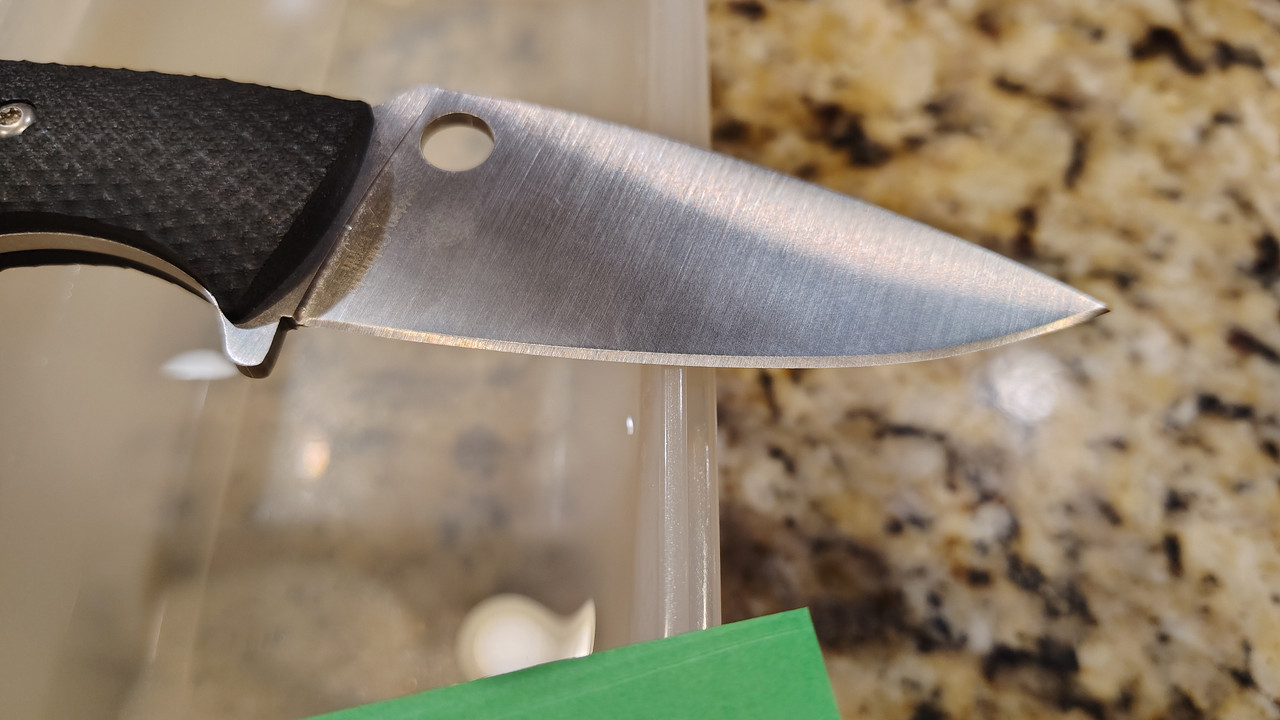

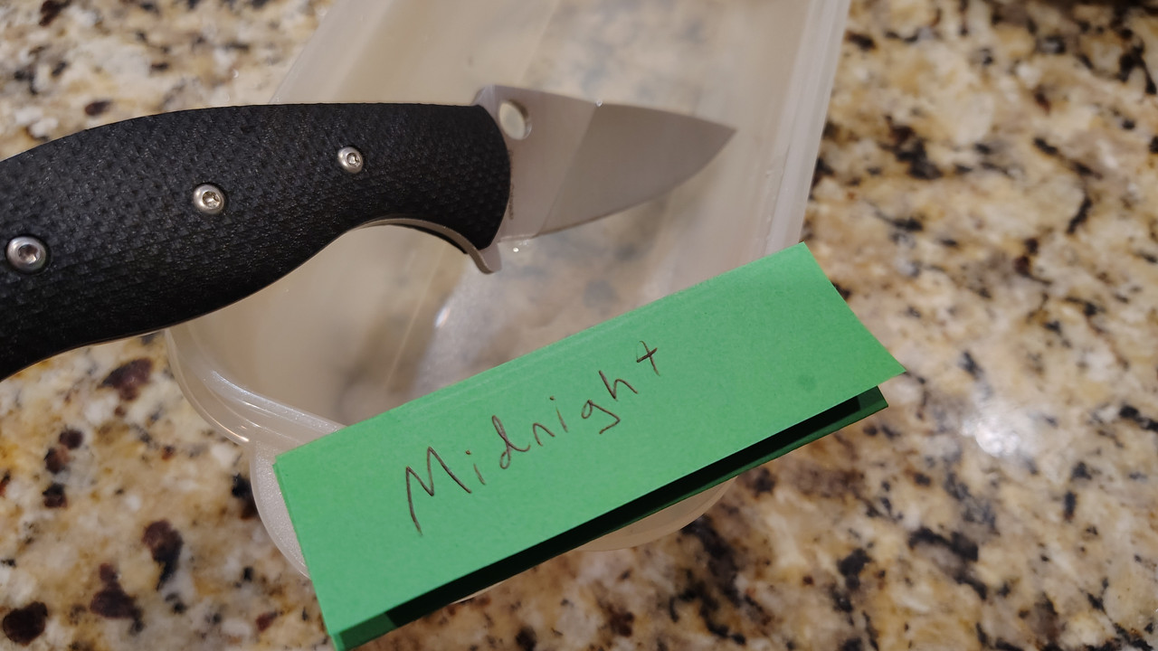

Here I am setup for the next stage of the test.
I cleaned out the container and did the same ratio, 3 cups water, 1 tablespoon salt.
Cleaned up the edge with an abrasive green dish scrubber so the rust was gone, no soap or bar keepers friend required.
touched it up on the sharpmaker again to give it a fresh edge.
Placed it in at midnight. Plan to remove it at noon later today, document the results, then move on to some edge retention testing.

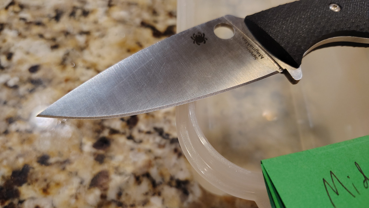

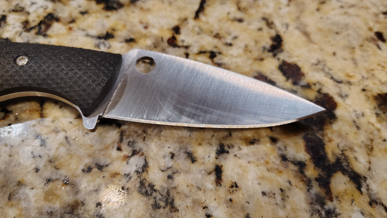

results from an 11 hour soak in salt water without other knives as potential contaminants confirms two things for me.
1 - when polished, magnamax has very good corrosion resistance.
2 - magnamax will not be a part of the salt line-up.
The edge went from aggressively sending arm hairs flying to just barely being able to scrape shave after 4 or 5 passes on the same spot of my arm. Very noticeable edge degradation.
So in my eyes this seems more along the lines of S110V but tougher than Magnacut with more edge retention. Time will tell.
I'll try to gather up all the cardboard I can and get to working on edge retention testing later today.
