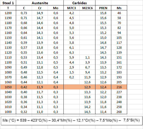

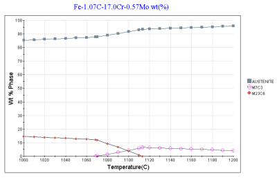

Post by Librarian »
Deadboxhero wrote:
Thu Sep 04, 2025 2:52 pm
Between these two steels, which is more corrosion resistant and most importantly why?
To answer simply, steel 2 will have better corrosion resistance than steel 1, since the matrix contains more chromium, molybdenum and a little nitrogen (Unless, of course, the PREN index is used to assess corrosion resistance). Of course, provided that the heat treatment took place at the specified austenization temperatures, followed by low tempering and other nuances.
Steel 1
Steel 2
