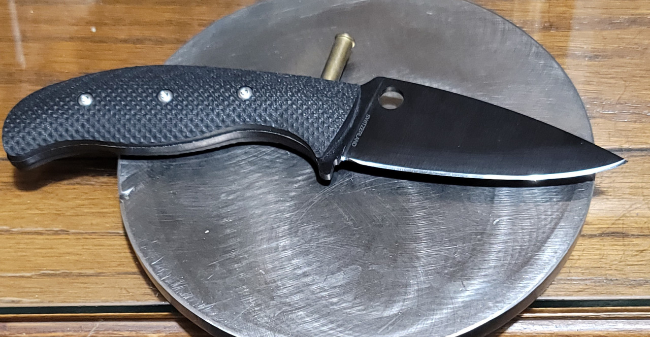

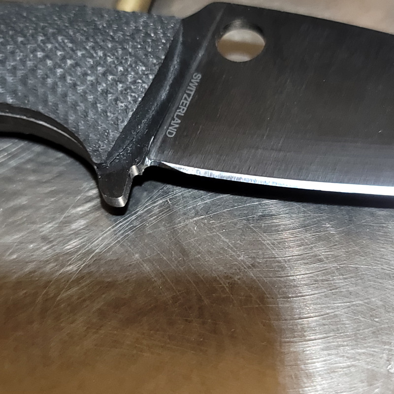

Got the HIC Mule in today and I must say I am quite disappointed by the lack of an actual bevel on this blade... what bevel there is, it's not even from shank to point.
Looks to me, like when they did try to put the edge on this blade they did this with something that was about .375" wide and a powered wet wheel maybe, and it has dug in in parts of it and other parts of the bevel it just kind of rounded it over, then they flipped it over and repeat the same attempt at a bevel on the otherside.
I basically got a Shiney, wavy line down where the cutting edge should be. I am totally shocked at how this blade looks and feels.
Heck I don't have anything here to even come close to being able to rough a true bevel in on this blade, heck I think I can keep one maintained, but not even sure of that; and the very reason I bought this was to see if I can even keep a good edge honed on it.
Didn't even think it was coming without a good edge to begin with. I do like the color of this blade, the thing doesn't weigh much either.
You other guys that bought these get them like this also?

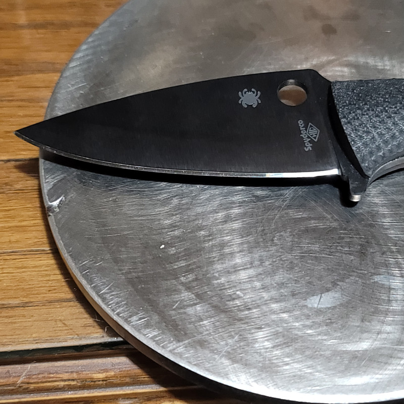

Still working on getting the bevel profiled in this hard blade. Without doubt the hardest blade I have ever honed.
This HIC is simply amazing at how hard it is. I have decided to hone this at 19 dps and I can safely say I got the biggest part of the bevel established at this point. Finally lol
Still have not ordered a finer grit hone I need for the finished edge, just so many things going on around here that gets in the way of these more fun projects.
One thing is for sure, honing the edge on this blade darn sure doesn't happen quick, at least with mine it hasn't lol. There was a lot of material to remove even at 19 dps .
I really like the black color of this Mule also. Going to be really interesting to use this once I get it honed properly...

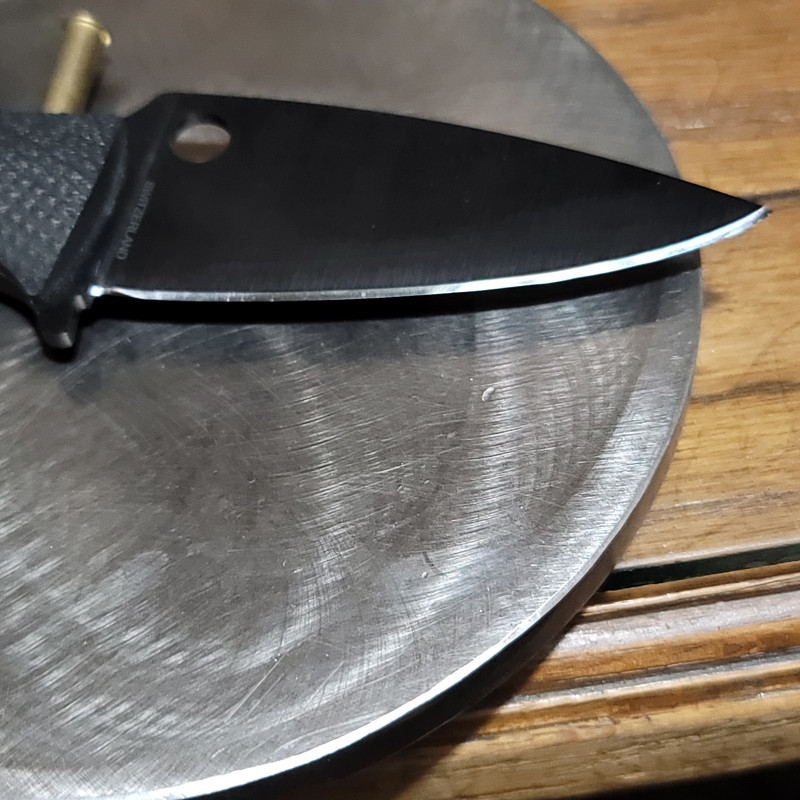

Well, I still have not been able to hone this HIC Mule to Razor. It isn't from the lack of seat time on the hones either.
I have the honed bevels on this Mule where you can see yourself in them lol. They are a true 19 dps profile, which may be some of the issue here with it only being just really sharp.
I have concerns of this blade being made from ceramic breaking and or fracturing, is the main reason I started this blade at the 19 dps. Heck it's my first ever ceramic blade and I have no idea what I am doing lol.
I just know this blade is really hard and the blade has taken me many hours to get it just sharp. To re-profile this blade to a lower profile would be a major challenge for me if that is what I need to do lol.
Yet, here I am with this HIC Mule and it's only just sharp. Heck I don't have any blade around here that isn't like a Razor or I can hone out to one in short order.
The ceramic is kicking my tail lol. I have had visions of taking this blade to my 12" X 2" bench grinder and re-profile it on that sucker lol and then I just wake up lol.
It did really well all day yesterday around here using the hound out of it to see how quick it would dull out, or break. I shaved bark off tree limbs and even hacked at a few smaller, more hairy limbs that just needed to be cut from the big hardwoods and Cedars around here.
I can't say enough about the black finish on this Mule either, I really like the finish. I took B-12 Chemtool to clean all the sticky tree sap off it and never once had a concern. Looks brandy new and it's still just sharp lol...
Just wanted to report back on this, and if anyone has a better profile to use on these I am all ears(eyes, since we read here)...

Once the alcohol has dried off the hone, it's time to rinse off and re-wet the hone. The alcohol dries so nice not leaving a mess on the concrete floor too.
As hard as this material is, in my mind it should be able to be honed to a Razor sharp edge. But I have not read anyone mentioning this.
I am wishing I had chose a more flat blade angle now with the results I have gotten lol. A re-profile of the 19 dps may be required is my thinking on this to get this blade any sharper. I have never seen a Razor made from anything that was really thick lol.
This has been a very interesting material, very time consuming as well. If I do re-profile the angle that will really be quite time consuming lol. Thanks again for your response and the info shared.
Re: MT40 HIC
Here my HIC is at 19 dps, part of the blade right by the finger choil never cleaned up with the hone so far, I think it will show in the pix.
I have messed with this Mule at 19 dps ever which way and yet it's not a Razor... it will shave hair, slice paper all easy enough, but it's not like the humpteens of other blades I have around here. Which is they all are like a Razor!!!
So, I started to re-profile this hard headed ol'e Mule to 16 dps this time. Heck I am still so uncertain about this being made from ceramic, I am afraid to take it to low of an angle, fear if it breaking and chipping or fracturing.
I have never had anything that was really nice and hard metal, that could not be really sharpened to Razor like edge. Been honing on this Mule all day, to re-profile it and start this Mule all over differently.
Re: MT40 HIC
While the re-profile from 19 dps to 16 is some really slow going I have been thinking more and more toward going for 15 dps, after all I like most of my knifes at 15 dps and they are all honed to a Razor right now with the exception of one that was used hard yesterday lol.
Re: MT40 HIC
Ok, I got three other new knives in last week, so I got off this HIC Mule for a minute to re-profile them all at 15 dps.
Two were M4 steel and one was M398. So all this took a minute or two lol. There is one thing I have seen, the HIC Mule has smoothed the diamond grit right off 4 hones already and I still lack a long way from having this Mule profiled to 15 dps...
Didn't notice it till I switch from the HIC to the M4 steel and I could tell instantly that 4 of my nice diamond hones were done far lol. The HIC Mule is one more hard devil...
So, now I am back on the HIC Mule and I guess I am going to be buying more diamond hones to get this Mule profiled... all I can say is wow.
There needs to be something that is a powered, wet wheel for this HIC, least to get the angle profiled close. I am sure they make one, I just don't have one lol, they are probably big money for a good one that you most certainly going to need for the HIC. I have never messed with the ceramic blades and only have the one.
I got all kinds of grinders, sanders and hones for steel. Never did I expect something like this beast of a blade. I will get this blade profiled to 15 dps though, even if I have to buy a pallet of hones to get there lol. Heck, I have sharpened more than just a little tungsten and it's hard to mess with, but it's nothing like the HIC...
The edge I got looks good so far, it's just taking forever and using up a lot of good diamond hones to get there.
Re: MT40 HIC
I’m wondering if a paper wheel on a bench grinder that was impregnated with fine diamond powder would make these hair popping sharp. Question is what to use as the binder, wax?
