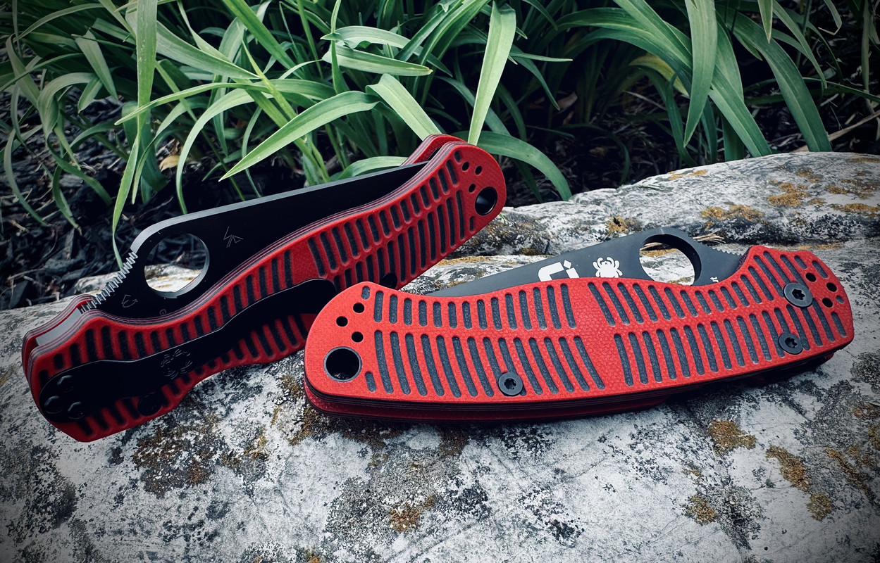

I’m not sure I tricked you guys by telling you how I did that and that anyone can make a red-ribbed PM2 if they want. There was no special trick to dyeing the scales — my standard recipe of half a bottle of RIT dye (scarlet red in this case), 1/2 cup of white vinegar, and 4 cups water brought up and held at a very low boil. I dipped the scales in on hangers made from wire clothes hangers so the scales don’t touch the pan and dyed them for about 20 minutes. After a good long rinse in hot water, the originally yellow ribs were now red (and near spot on to color of the Crucible handles). After that I just swapped my DLC MagnaCut PM2 setup into the scales. As I said, anyone willing to buy both MC PM2 versions and some RIT dye can do the same. Cheers, Radioactive

Thanks for the formula. I will definitely try it out on the para 3 when it comes out.
The trick was, there wasn’t any context when you posted it originally and not saying it was dyed. We all got excited that the rest of the population would have a chance at a black/red version.

Tried Radioactive’s formula and I think I messed it up

Look really good to me. Just need to be tip up right-side clipped. Lol
