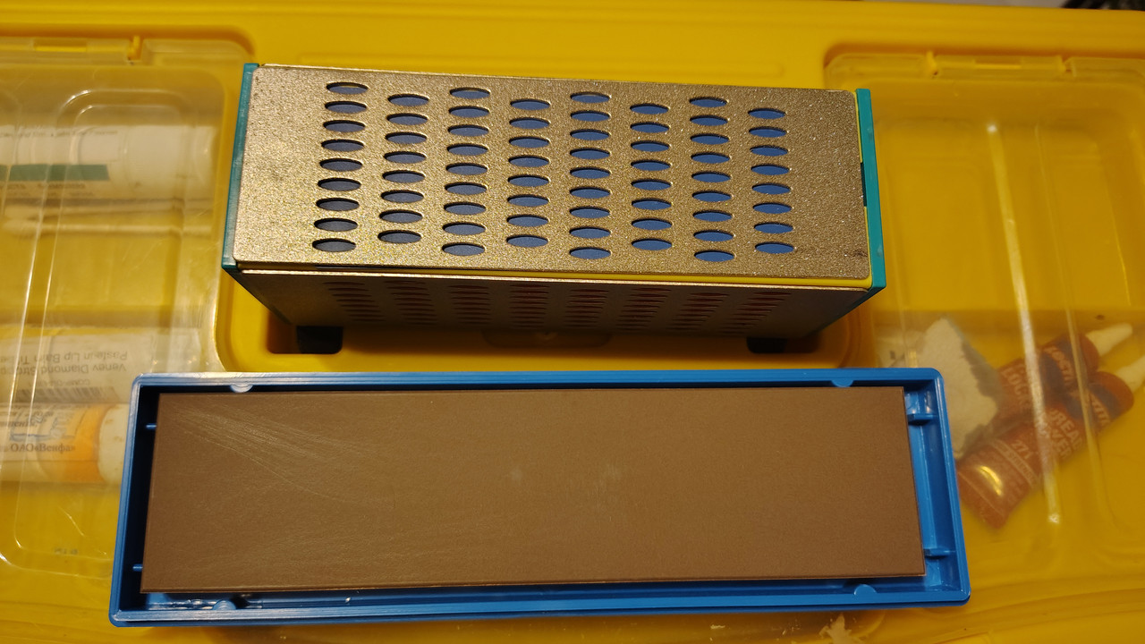

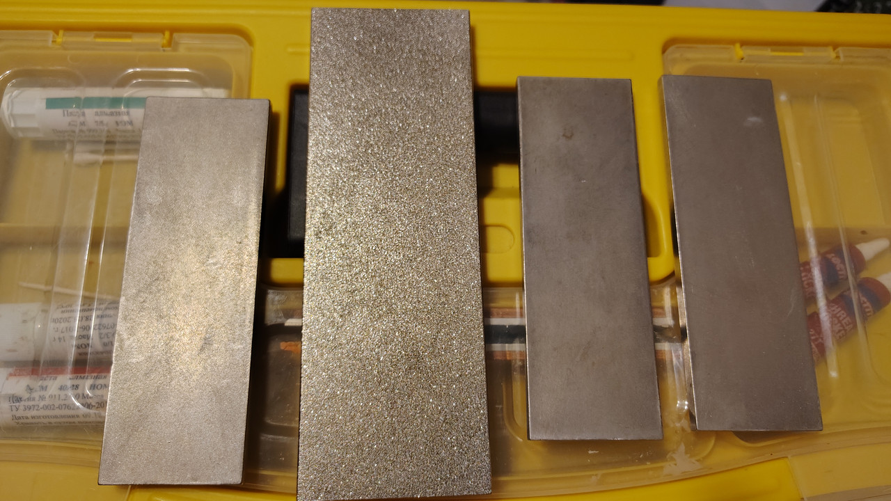

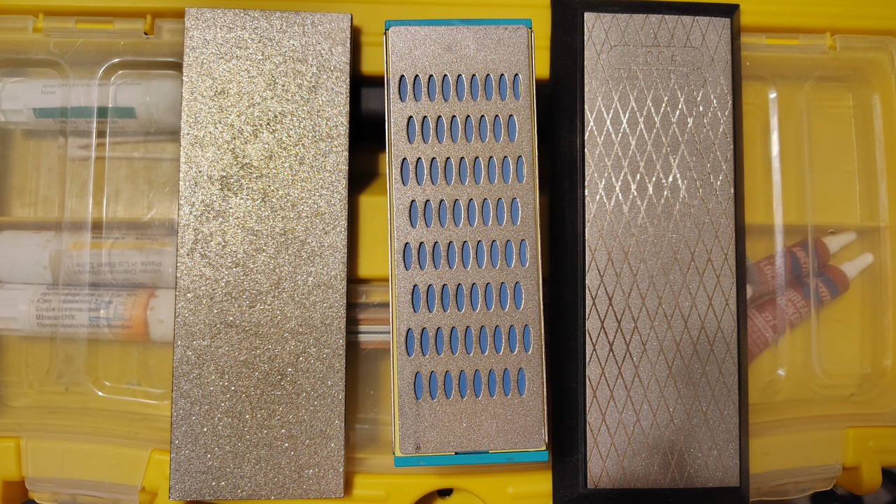

Here's some comparisons between stones I've discussed and the HF stone.
HF vs Spyderco medium
Chef knives to go also sells a 400/1000 grit two sided bench stone that's a great value. Only issue is the included base doesn't have much clearance for folders. Here it is on the right, with their flattening plate on the left:
6" DMT's VS CKTG flattening plate
