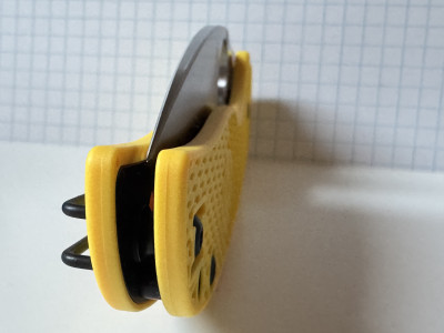

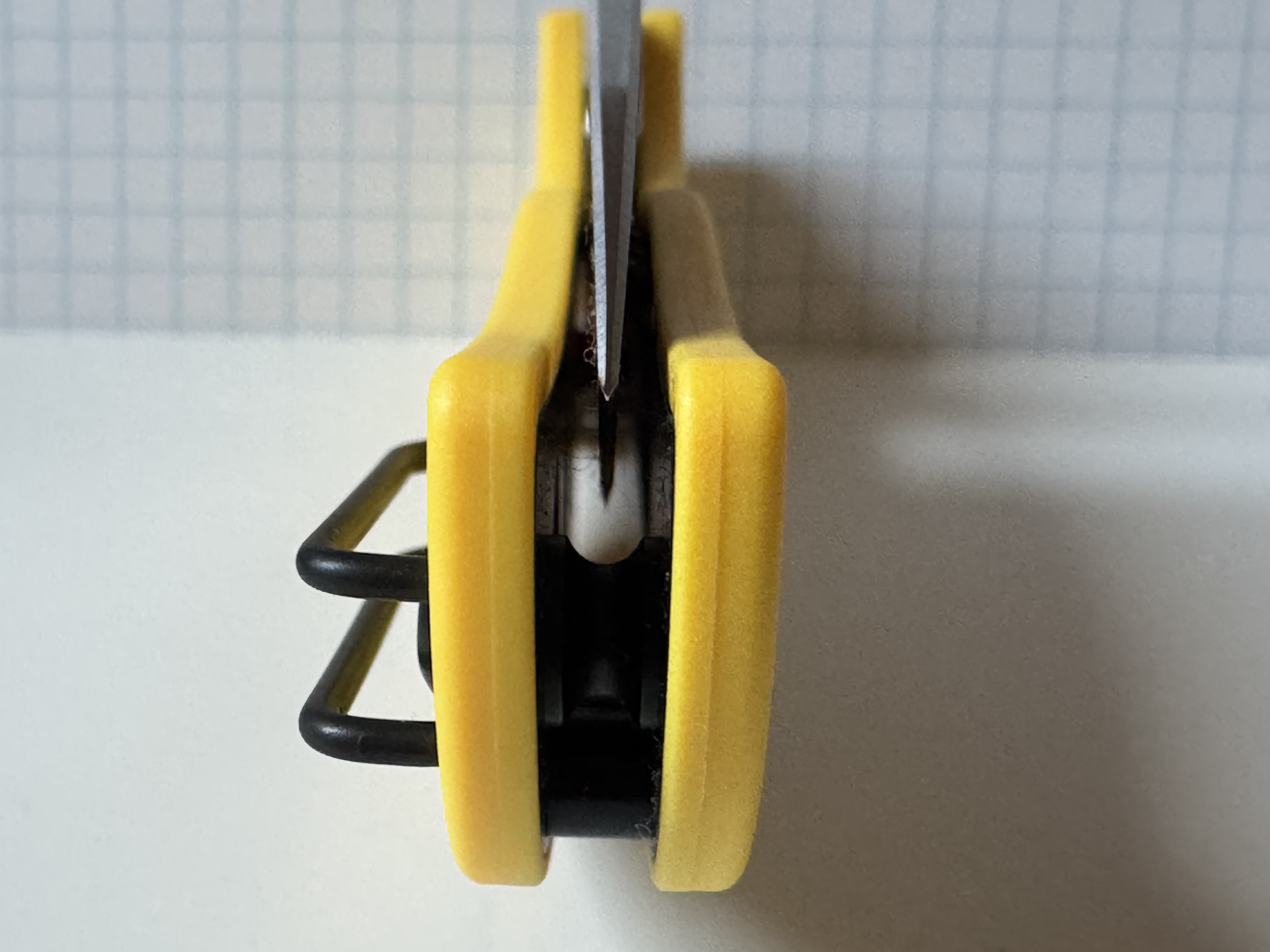

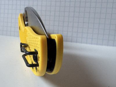

Hello All!
I’m new here and glad to join this great community!
Probably I have the same issue with my brand new Sage 5 Salt.
Is that tip‘s position okay for this model or something that I should be concerned about?
Re: Sage 5 LW advice
I own 3 Sage 5 Lightweights (including a Salt) & have never cut myself on the tip in a closed knife, though I suppose some risk is there.papa_pinguin wrote: ↑Fri Jul 11, 2025 1:47 pmHello All!
As @holokai has mentioned in his post above, if you sharpen enough times that the tip starts protruding, you can simply "drop" the tip by taking material off the spine. It's easy to do if you have access to a belt grinder, and I've also done it manually with a 150 grit diamond plate when I had to reprofile a PM2 in S30V that had its tip broken off.
It should take a whole lot of sharpening & reprofiling before your S5LW Salt gets to that point, though. Unless that S5LW Salt is your only folder & you sharpen it very aggressively at even the slightest hint of a loss of razor-sharpness, it should be years & years before it becomes an issue. You generally don't have to take off a lot of material to keep a folder sharp, unless you're trying to remove a chip or a roll at the same time.
