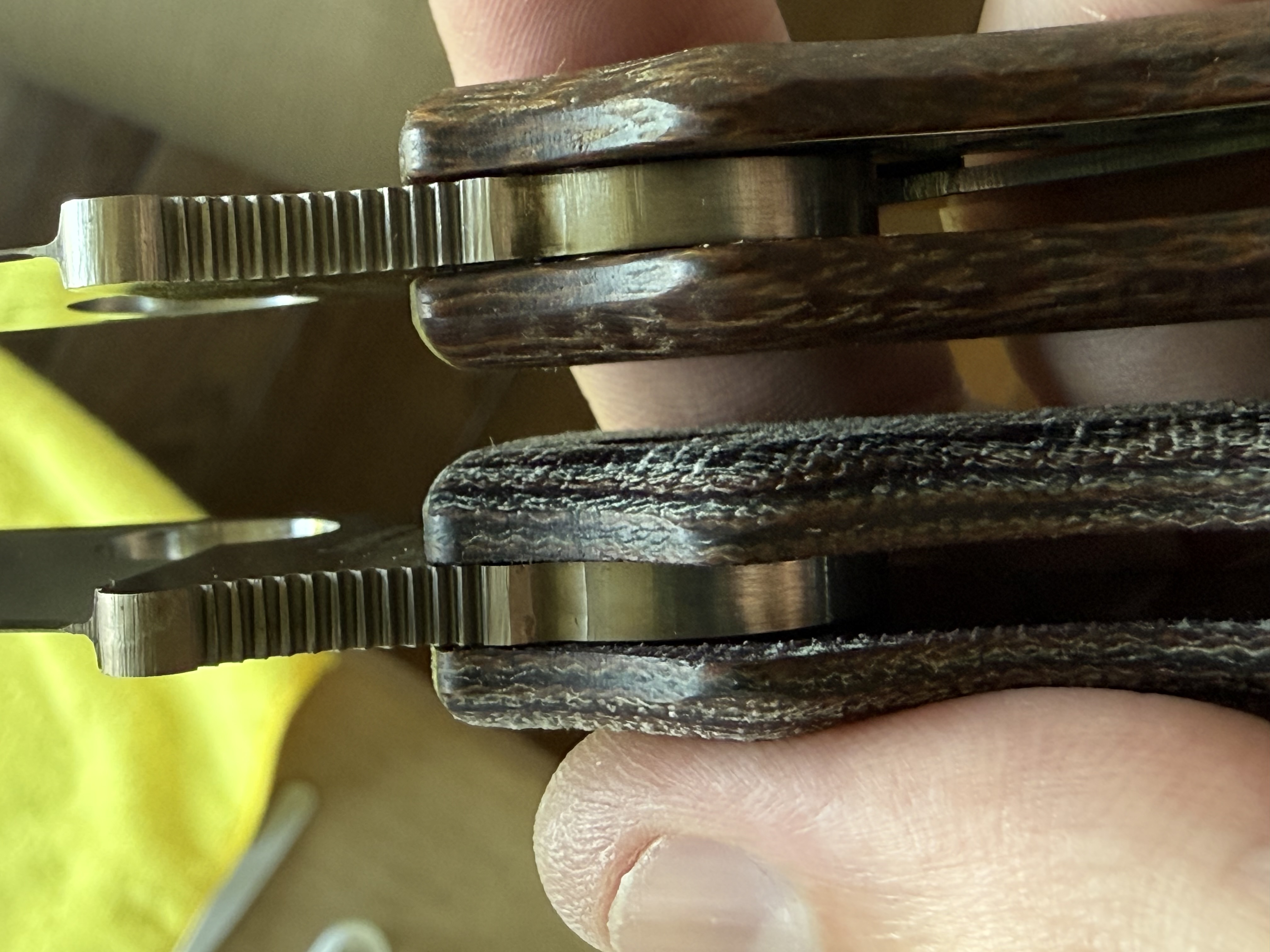

WilliamMunny wrote:
Fri May 02, 2025 6:40 pm
Fri May 02, 2025 5:41 pm
I checked all of mine. The Spy 27 is the highest but not protruding. If you rub your finger over it, does it get your finger?
If I push my finger into it a bit I can feel the point. The point is within the scales but close enough to the top that I feel a few sharpening sessions would bring it even higher and even to the scales, especially if I take a lot of steel off reprofiling the edge.
I don’t think it’s as bad as some of the SPY-27 but I think it sits higher than it should. I could be totally wrong on that though.
Otherwise the knife is great no complaints at all.
Unfortunately yeah, I'm not sure if I can link that original thread but a user said that a dealer had maybe 10 different SPY27 models with all the same issues.
With Sal's response, definitely send it in for them to look over. I believe they'll take care of you, as this company seems very committed to its' customers.
Very happy to have joined the Spyderco family with my purchase of the 15V BBB Millie 2 and 15V Shaman(15V Shaman is my current favorite EDC).
Thank you everyone who took the time to comment in this thread, and thank you Sal for confirming it was isolated to a select few knives.

Skylark427 wrote:
Sat May 03, 2025 12:09 am
Edit: I included a link in my previous comment of the original post on Spydercos community on reddit. I posted Sal's response there, so others know what to do with their knives should they have this issue. If the link breaks any rules, I'll gladly remove it.
Spyderco has the best customer service of any company I have seen. Got my first Spyderco from my dad about 30 years ago now and have not looked back. This is probably my first concern I have seen on a Spyderco which honestly most people probably would no notice but being a “knife guy” I noticed it might be an issue.
Thanks everyone for the input, knife will be in the mail today.

I wanted to come back on here and thank Sal for coming right back to this and making it right. It’s just a perfect example of how Spyderco came to be and continues to excel with excellent products and customer service. The fact that you are taking time out of your day to make this right speaks wonders to who is behind this incredible company.
Im glad this got noticed a bit more, but most importantly ownership was taken immediately. My knife was received this past Friday, not evaluated yet, but I’m sure they will make it right.
I appreciate everyone’s involvement this and a special shout out to Jacob for his help.

So I don’t have this issue with the Spy because I don’t own that one but I do have the problem with my burlap S90V Shaman from knifecenter.
Someone pointed this out but it is 18000% due to the grinding of the blade behind the finger choil where it interfaces with the stop pin.
I got the gorgeous 10V boa micarta Shaman and it is perfect. Check out the side by side of the 10V vs the 90V. You can see how much more material there is on the 90V. Looks like the lathe was set just a little too shallow when I compare them directly side by side. My S90V has never been sharpened and will probably snag after one sharpening.
I’ve owned this knife for like a year now though so if I want to fix it, I’ll try sanding down that part a little to see if I can get it to improve without killing the detent.
