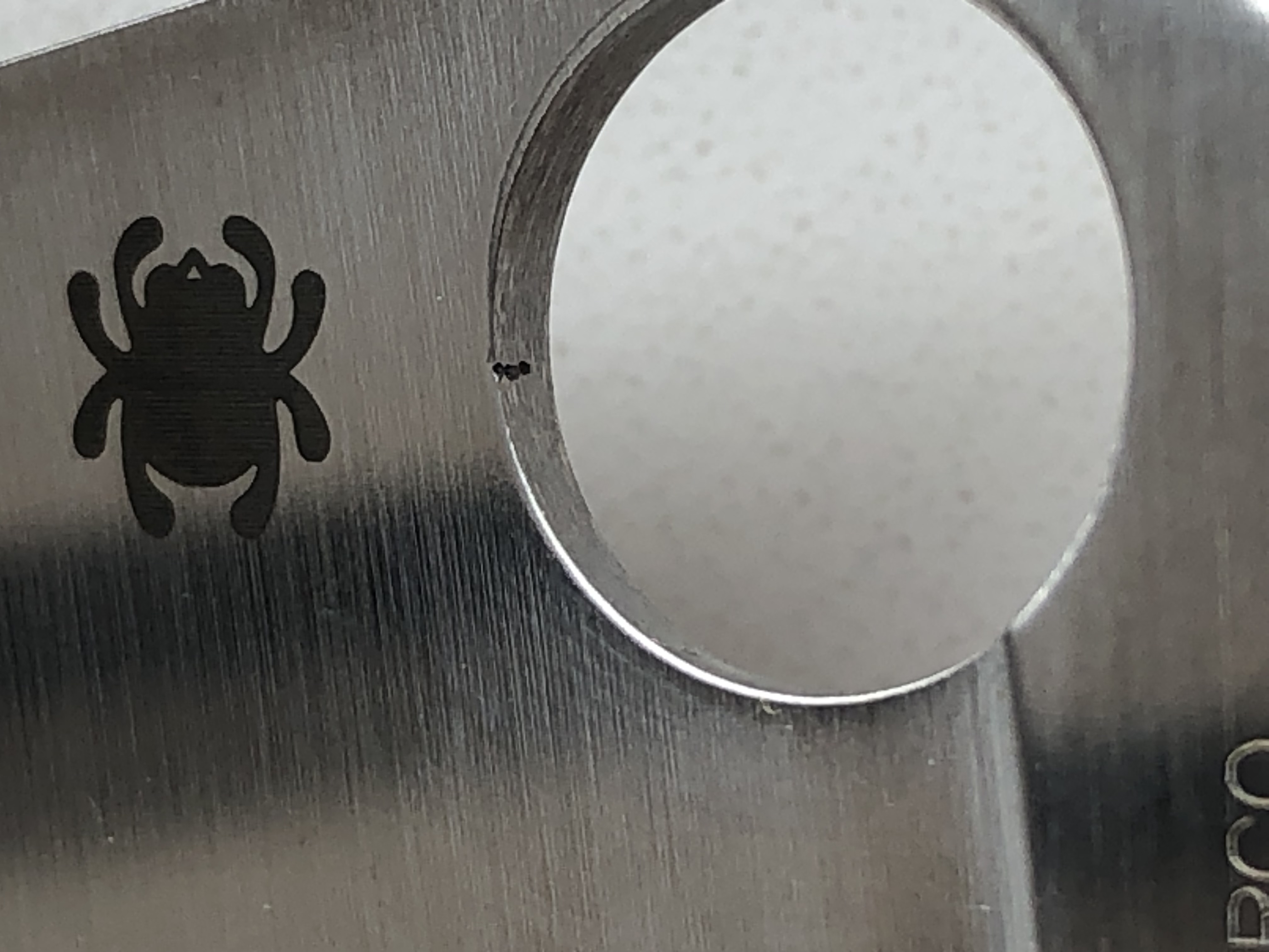

Michael Janich wrote:
Mon Mar 04, 2024 6:45 am
Dear kojaq48:
Could you please tell us what portion of the blade has the chips? I see them clearly in the photos, but I'm not positive where they are on the blade.
Thank you.
Stay safe,
Mike
Hello, Mike!
Exactly as Giygas wrote,
“This is the part of the catch that the bolt catch engages.”
Since I bought the knives new from the store, I returned them. In my eyes, this is a manufacturing defect that may affect the use of the knife in the future.
I decided to give Spyderco a chance one last time and bought Endela frn K390, because I really wanted a knife with this steel. And how surprised I was when I opened the knife with my thumb for the first time and felt something strange under my finger, something I will show in the photo.
Gentlemen, I'm giving up now, of the three knives I purchased, three of them have a manufacturing defect, after all, these are new knives from the store and this shouldn't be the case. How is this even possible…

Try tightening the body screws. I thought some of my Seki models had lock rock but it was because the body screws weren’t tight enough, none of the screws came with loctite on them.
