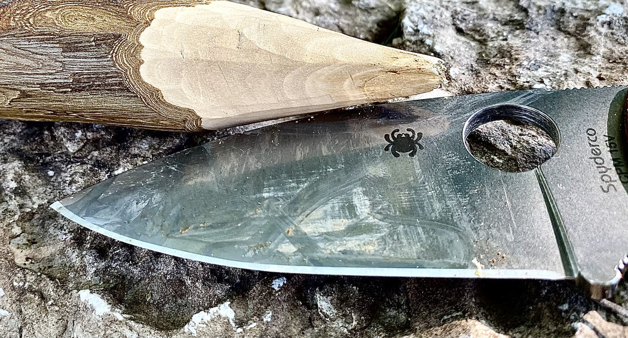

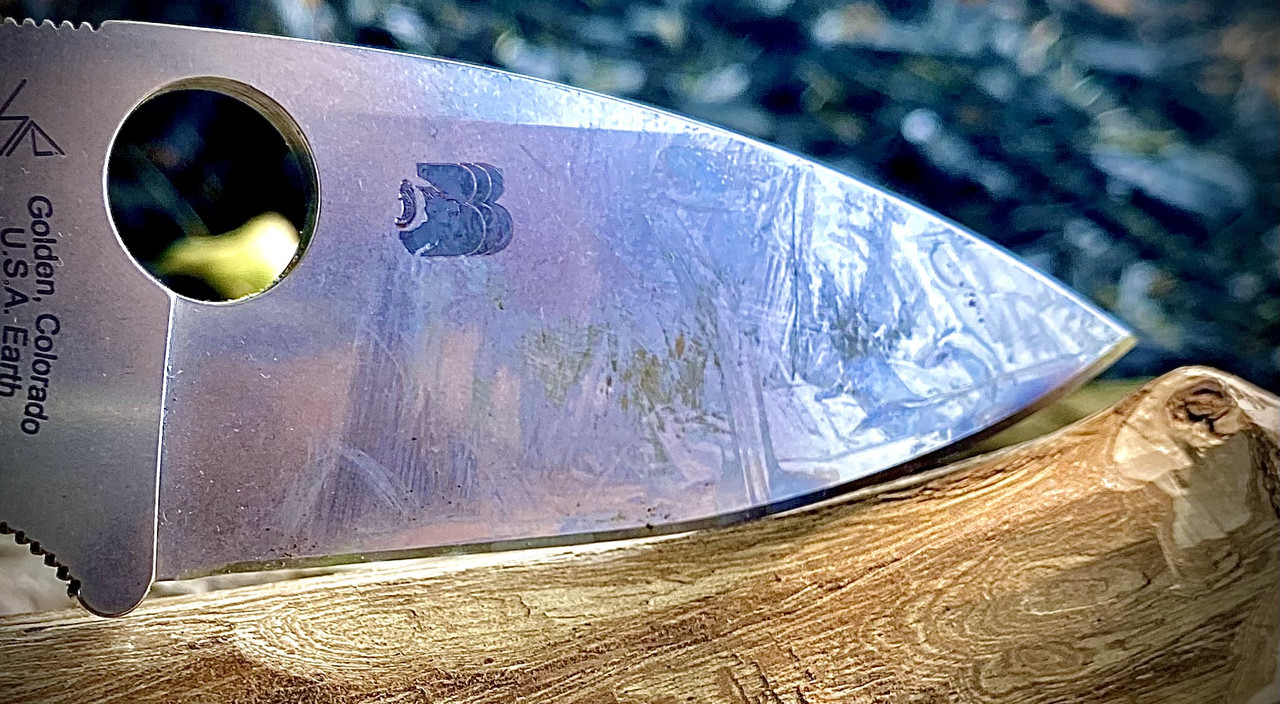

I’ve used my Shaman 15v really hard. And it just keeps going.
Just a quick strop with diamond solution and back at it.
This edge has been through the wringer. Still hasn’t seen a stone. I approve! This is around a year of use.
