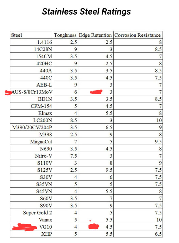

Added to my post above:
VG10 actually having better edge retention than 8CR also shows in Dr Larrin Thomas charts (https://knifesteelnerds.com/2021/10/19/ ... esistance/)

Re: VG10 Wear Resistance
thanks for bringing this chart to my attention! now that I look at it and see it, I wonder if what is happening in my test of VG10 is that the lower toughness of the VG10 is resulting in micro-chipping or rolling of the edge and that is causing it to no longer slice the paper at 80 cuts. its not necessarily that the edge is wearing away, its just that it is deforming due to less toughnessWartstein wrote: ↑Mon Nov 18, 2024 10:25 pmAdded to my post above:
