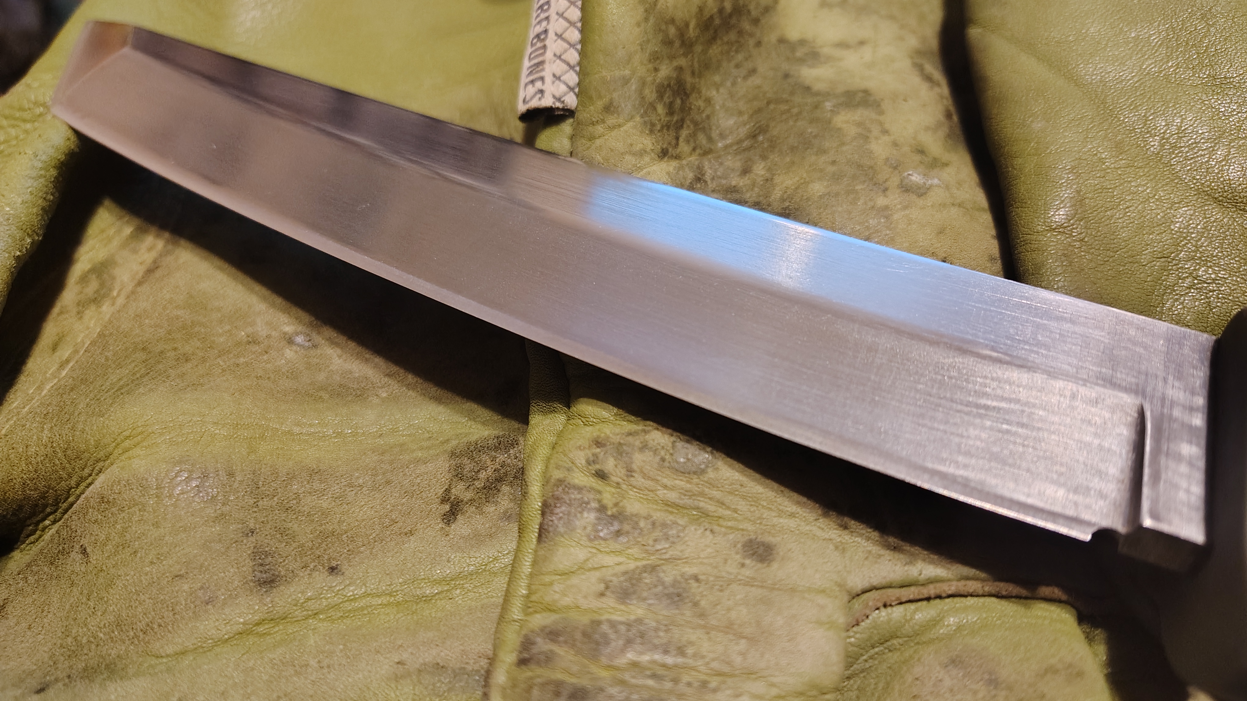

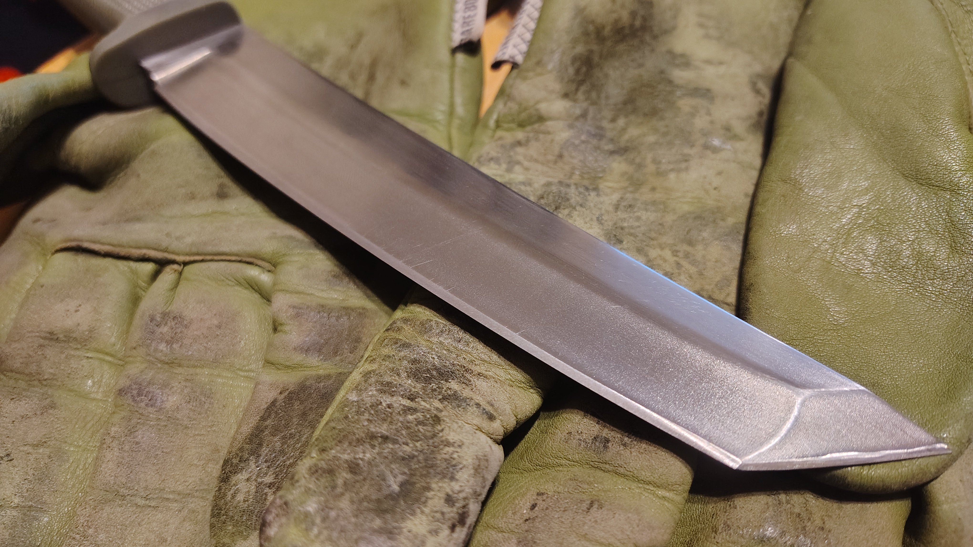

Recently sharpened out some chips in my 28" chopping axe, and polished up the edge of the Recon Tanto I stripped.
Just did a DMT fine finish for now, then ran the apex over the medium rods for a few passes.
Once I settle on how thin I'll be keeping the edge I plan polish the rest of the haze out of the blade then take the edge bevel up to 5,000 grit.
SK5 takes an incredibly edge very easily, but is quite fast to rust. So the polish will be for corrosion resistance more than aesthetics. I've stripped SK5 SRK's and left them fairly raw, so I want to see how well the steel holds up with a nice 1,500-2,000 grit full blade polish.
