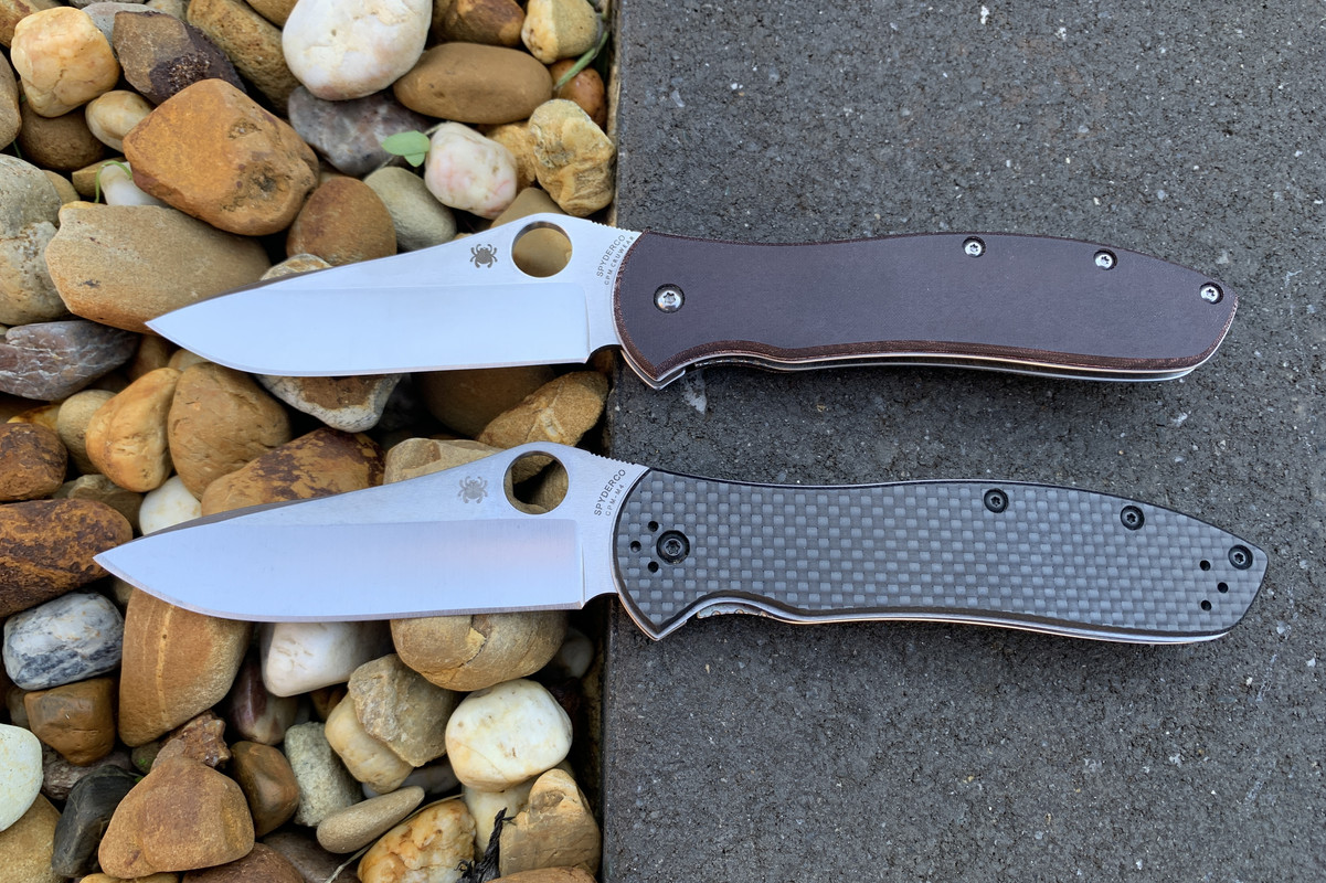

Re: Gayle Bradley 2 CQI?
My first one in M4 had bad lock stick and week detent and I improved the detent but couldn’t get the stick out and didn’t really carry it much…when I got the Cruwear version I switched out the hardware, got some Micarta scales and sold the M4 with full disclosure…I took a loss on it but absolutely love the Cruwear model because there’s no lock stick and detent is acceptable although I’ll probably tweak it a little.
