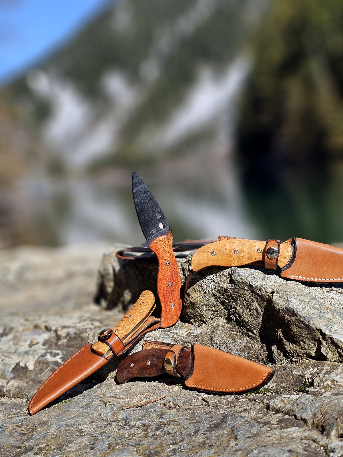

Post by FullScaler »
Took some of my Mules for a hike today. They got to ride in their cozy new sheaths and the new messenger bag I am almost done making. The snow is melting and the ice is off the lower lakes.
I also got to test out my new HIC Mule s bit. I still can't get it as sharp as steel but it cuts apples well and shaves feathersticks too. It feels like a decent working edge but the feeling when cutting feathersticks is about the same as when my good steel blades are ready to be touched up.
It will be interesting to see how long it holds this working edge.

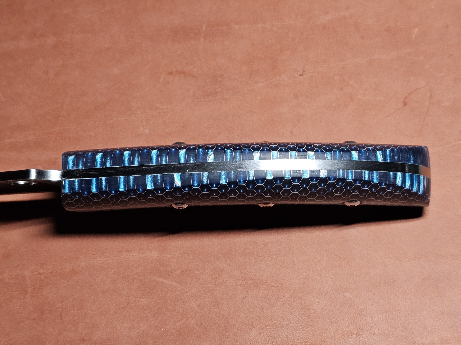

FullScaler
Posts: 273
Re: Show your Mule
#1817
Man, those Micarta scales look good @Ramonade Clean lines there.
I've been making so many wooden scales recently I wanted to try something different. These are aluminum honeycomb filled with dyed resin.
I think these are my new favorite scales. The way the aluminum honeycomb reflects the light in different angles is hard to catch in a picture but looks incredible irl.
Looks like I need to step back to about 600 or 320 grit in a few spots since I can still see lots of scratches in the pictures that I can't really see in my hand but I think it will be worth it to really dial these ones in.
I've got some red ones like this on the cnc now and will be trying some green after that. It's a slow process with these but I'm pretty happy so far.

Hey FullScaler,
That's beautiful. If you wouldn't mind, please tell me about this material?
FullScaler
Posts: 273
Re: Show your Mule
#1819
Hey Sal,
This stuff is called C-Tek Honeycomb Composite. It is an aluminum honeycomb filled with composite resin. It mills pretty easily but is a bit finicky to final sand due to the different hardness of the aluminum and the resin.
