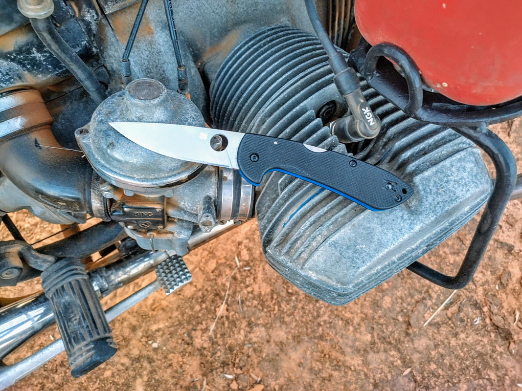

Hello DBCajun, any compression lock knife is likely to come open if you drop it. The best way to avoid this is to buy a lockback - they have strong self closing bias. Probably the best alternative to the Caribbean would be a Siren which is also in the Salt series and has an LC200N blade with similar length of cutting edge. This version has been discontinued but is still available. Here is a link: https://www.bladehq.com/item--Spyderco- ... ck--102051 .
People will have varying opinions on this but I think the Siren is a better knife than the Caribbean. Have a look and see what you think.
Here's a photo of mine accompanying me on my last desert motorcycle trip.
