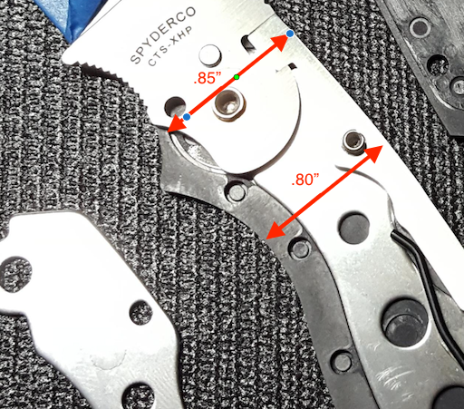

- If I understand the point about "fairly broad handles and blade ricassos" correctly:
While the Delica does not offer that, for example the Stretch shape should generally allow for a lock design like the Chap has with an internal stop pin?
Apparently the Delica is too thin in the handle's "tallness" dimension to add a stop pin. How narrow is it? I don't have one I can measure. Clearly .80" works, because that's the thin "tallness" dimension of a Chaparral.

Across the pivot it is .84 and 1/4 inch behind it is .75 for the Delica.
However, in addition to the handle, an important part of what Mike mentioned is the narrowness of the ricasso. The delica and kin have fairly streamlined ricassos with little room for internal stop pins.
The design seen on those images of a chaparral above is not possible on a Delica.
You could place a stop pin on the Delica, but it would not be entirely internal. Either it’s internal only in the open and closed positions, but travels beyond the handle’s margins on its arc, or it is entirely external (similar to some thumb studs that act as stops pins).
When it comes to backlocks’ lock rock, it seems possible to have the ricasso stop the blade in the closed position like normal with a stop pin to stabilize in the open position (preventing rock). However, you would often have that stop pin exposed, which I could see not being some people’s aesthetic preference.
Things like this can get a bit tricky.
I have no issues with the way my backlock Spyderco’s are now, as they’re very strong, but I wouldn’t mind extra stability when possible.
While not ergonomically perfect for my hands, I’ve come to hugely appreciate the Delica, Endela, and Endura’s design. I would not want them to change much at all, but I am all for Spyderco continuing to strive for better tolerances and ever better back locks with all of their manufactures.
Edit, I forgot to mention that the pathways for internal stop pins may also interfere with tip down pocket clip placement.
I also think the "broad blade ricasso" - thing Mike mentioned has to be considered too:
Cause when it comes to absolute handle tallness in relation to the blade-height in the tang area, I think an Endura should measure pretty much like a Chap (the Chap of course is taller in the handle in relation to its overall-, blade-, and handle length, so relatively seen).
And Mike mentiones the Endura as an example where an internal stop pin would not be easy to implement.
