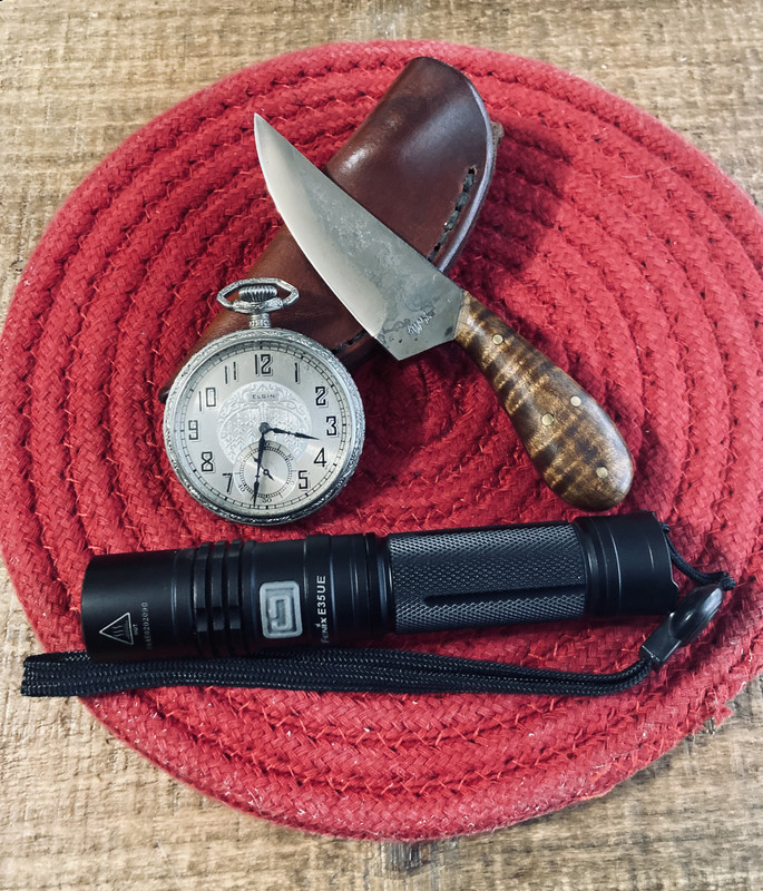

Steve Kelly Bany Skinner Custom in 1095 . MG2

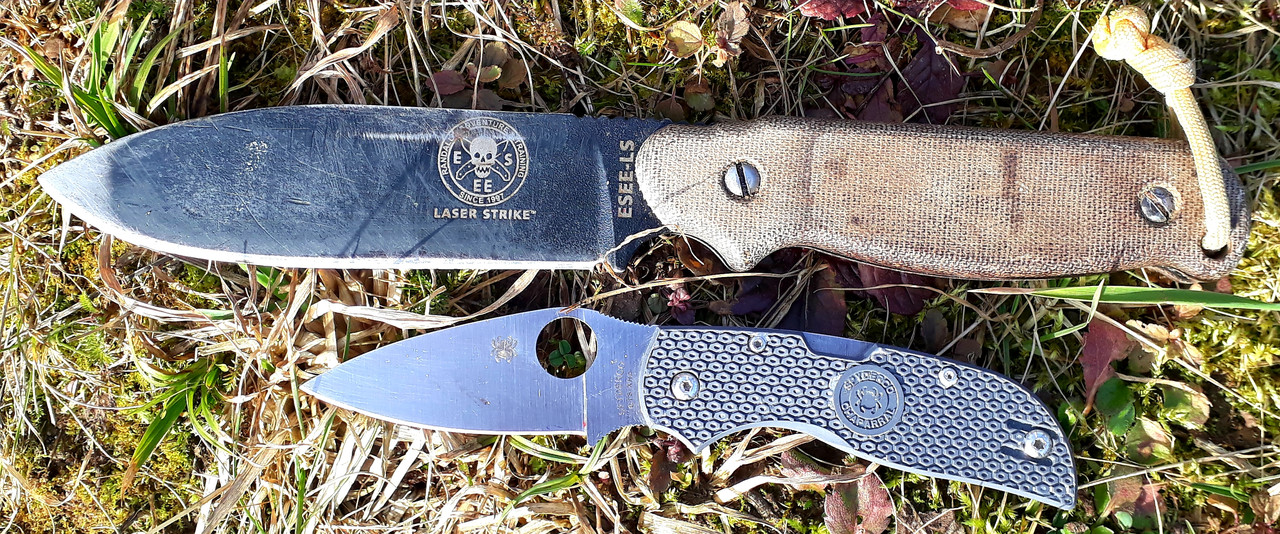

I have only one 1095 knife, my Esee Laser Strike.
I was really underwhelmed with its edge retention at first, especially since they claim that the Randall heat treat of this steel would get out the best of it.
After some sharpenings (getting rid of the factory edge) and a crude reprofiling to a more acute edge angle (it came really obtuse) the edge retention got noticeably better, but still is far from something to write home about.
Now what some folks, especially "oldtimers", claim is that basic carbon steels give you a toughness most other steels can´t.
Obviously, looking at modern metallurgy, this is not true.
Still I have to say: Before I got dedicated no spin throwing knives my Laser Strike was my main thrower for quite a while - and the blade held up really well to that extreme abuse, for which it definitely was not designed - and the steel not heat treated for.
No real damage, just slight chips and rolls, tip completely intact, despite hitting rocks, hard wood, and so on with much force.
Sure partly that will be due to the actually rather "non slicey", but brutally robust built of the Laser Strike (spear point, sabre grind), but also speaks for what 1095 can take.
/ And yes, I agree with Vivi: 1095 sharpens up very quickly and easily! And I am sure this could be done on the often mentioned "river rock" in a pinch.

Really? They do that? Honest question, I thought for a sword they´d rather go with 1065...
That and as in my previous post said already: In my use 1095 has been plenty tough too.
I´ll put the pic from my previous post down here again: You can see that the tip of that Laser strike has no coating on it at all anymore, while the rest of the blade does.
This comes from a lot of throwing (where obviously the tip gets the most "use") - and the blade held up really well to that extrem (mis)- use.
