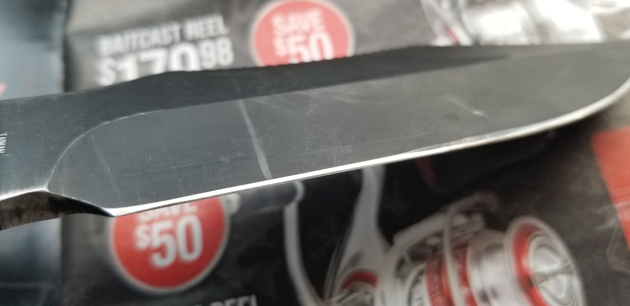

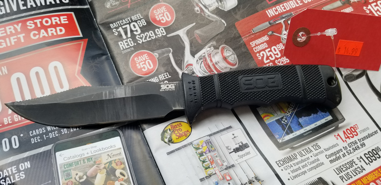

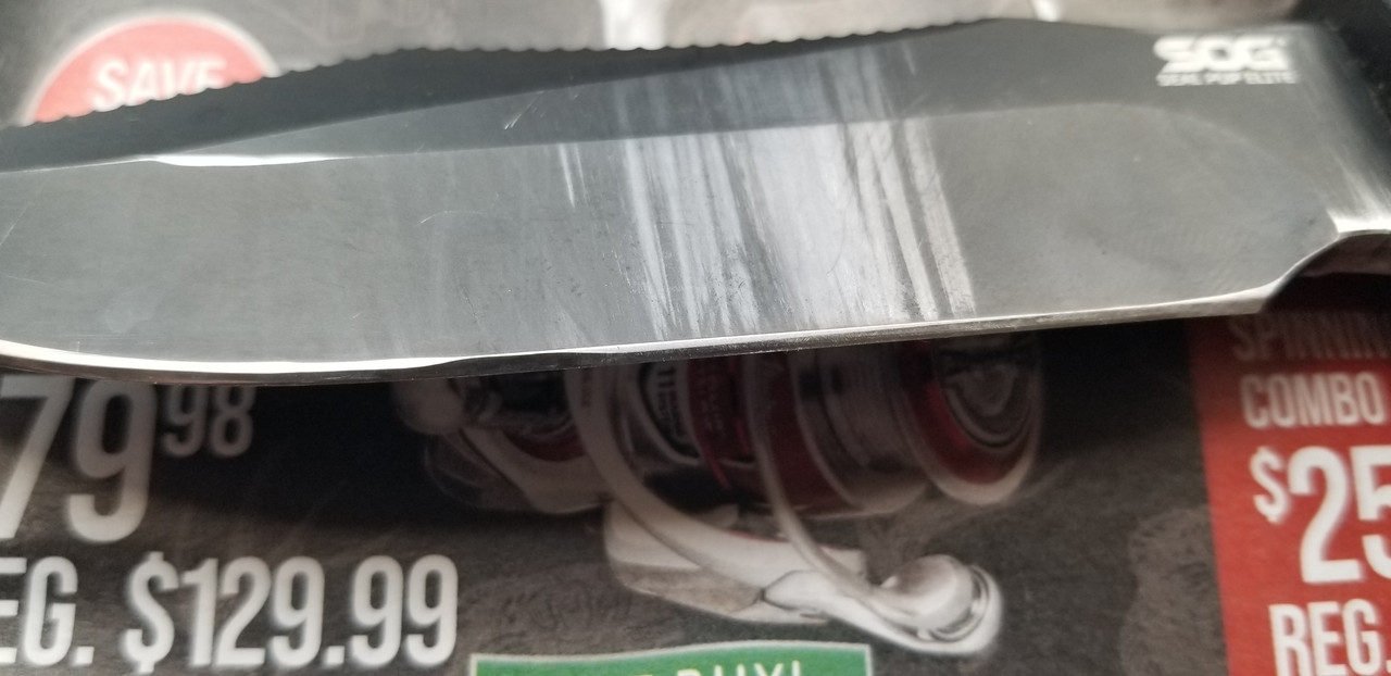

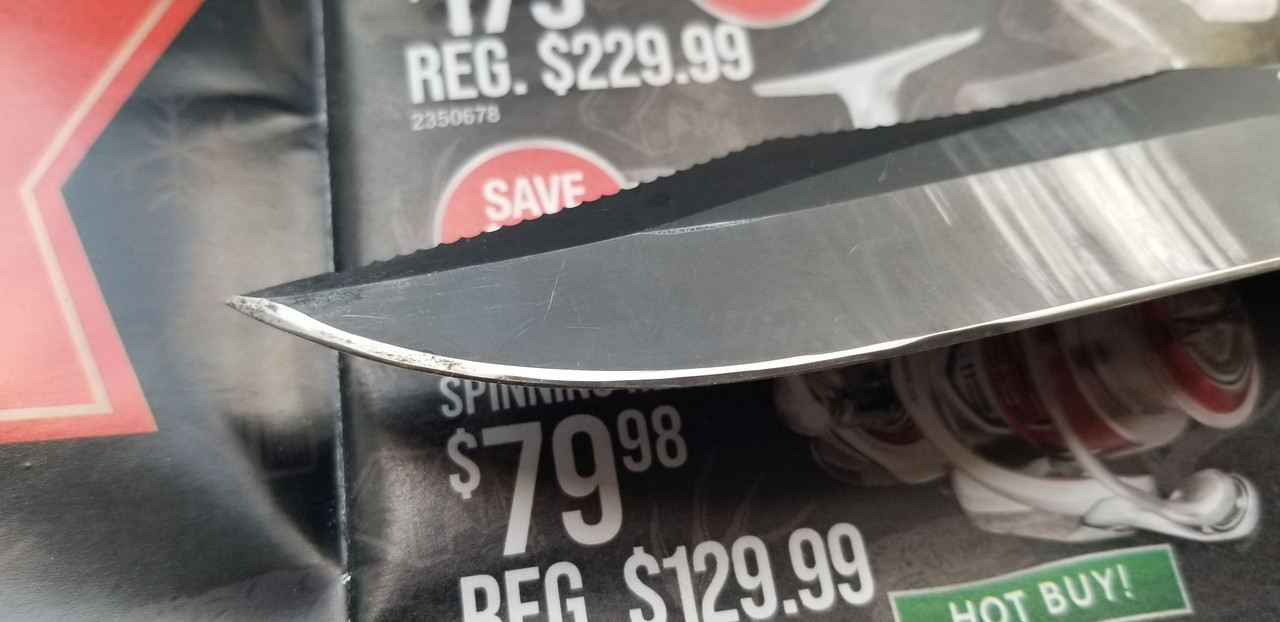

Picked up a used Seal Pup Elite with a hilariously bad edge. Like, 3-4 bevels in spots yet still so dull I can slice my skin with no effect. For the price I don't mind, it'll be fun cleaning up the edge and making a sheath.
