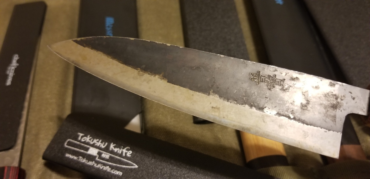

Big fan of white steel too. Doesn't hold an edge as long as super blue but the sharpening response is fantastic.
My favorite work knife is this white petty from Yoshimitsu.
Cuts very nicely. One day I'll thin out the primary grind some more, it's pretty thick towards the spine.
No issues with rust either, and I've cut tens of thousands of tomatoes, sliced hundreds of lemons, etc. Edge has never chipped or rolled when bumping into bones when cleaning whole bass, slicing up bone in steaks, etc.
