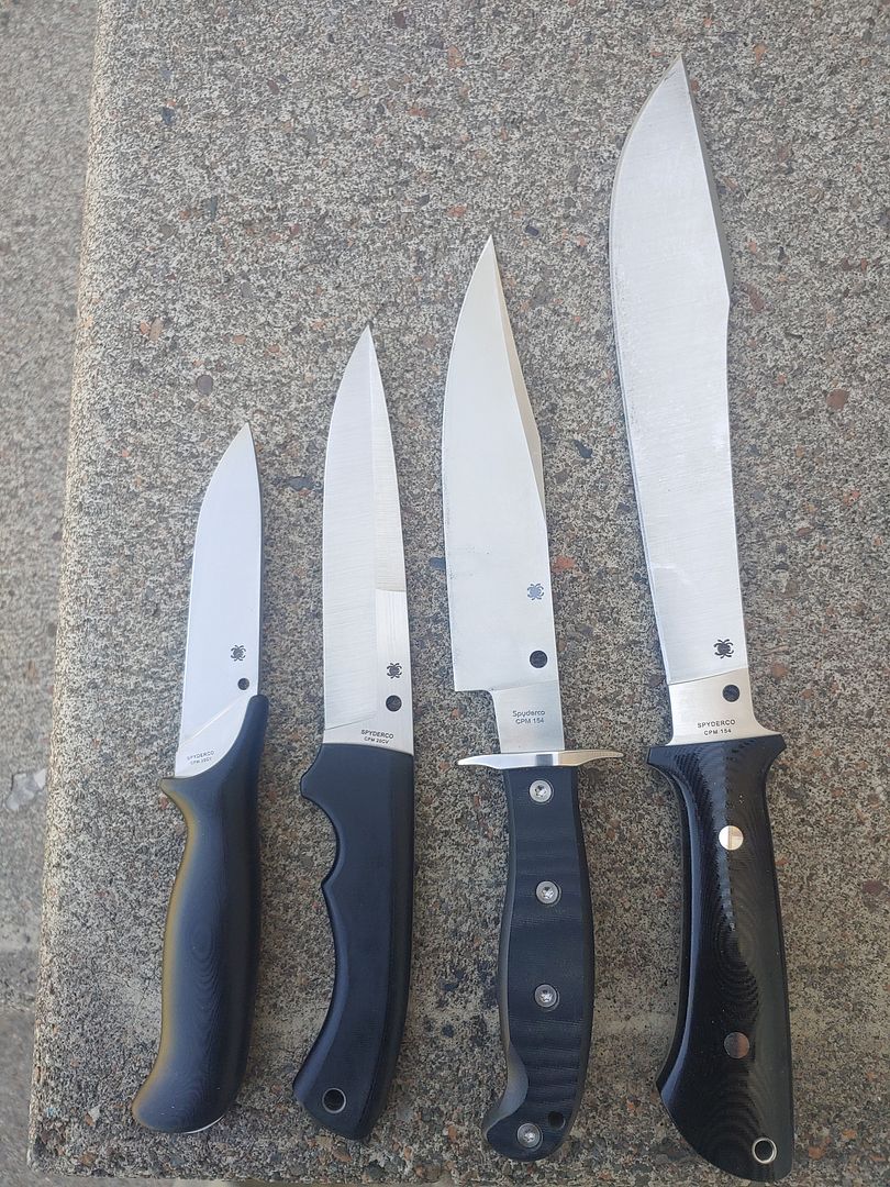

Can anyone shed any light on why Spyderco might have chosen to use 20CV in their Zoomer and Sustain models? I can get a fantastic deal on both models at the moment, and they would likely make excellent knives for work, but I am concerned about the relative fragility of 20CV compared to my more usual fixed blade fare of Elmax. Does the stock thickness mitigate any potential fragility or is it heat treated differently to thinner blade stock? I don’t pry with knives, but I do hack limbs off of trees when I don’t have an axe to hand.
Honest question, I’m not implying anything - I really am extremely tempted by one or both knives!

Both the Zoomer and the Sustain are collaboration models (Ted Zoomer and Stuart Ackerman, respectively). I would wager a buck or two that the custom makers designing them had some input on the steel used. I don't think I would tell either of those gentlemen that they don't know what they are doing.
I have one of each of the knives in question. The Zoomer is quite robust, and I have used it quite a bit cutting hard woods (by which I mean woods like oak, pecan and locust grown in near-desert climates) without issue. I have not used it for a crowbar, star bit, piton or axe, so I can't say how well it will stand up to such use. The handle is heavy enough to make the blade feel quite light, not the balance I would look for in a knife I planned to chop with.
The Sustain has a longer but thinner blade and much smaller, lighter handle, pushing the balance more toward chopper, but I've never cut a thing with it, just admired it. I love the look of it, but the handle is just too small for my XXL hands, and the blade shape is more fighter than worker.
Frankly, I wouldn't call either of them a large knife, and from your description of your use case, I think I would look elsewhere.

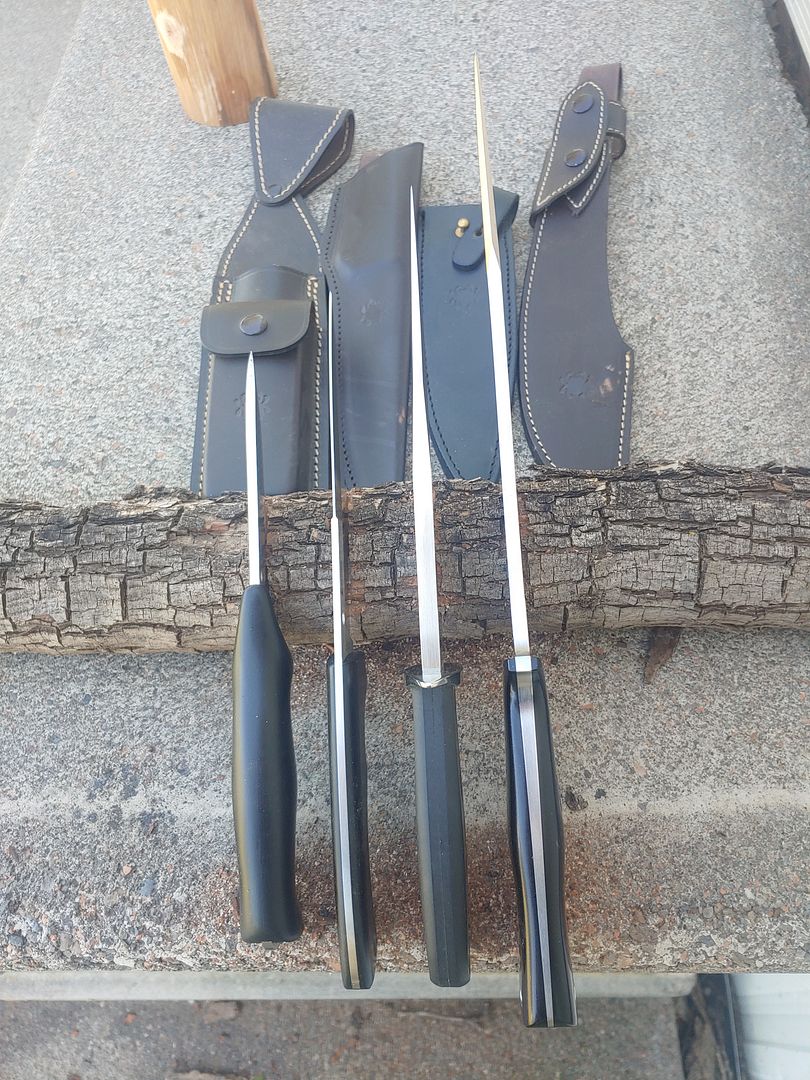

Woof. Sweet collection.
