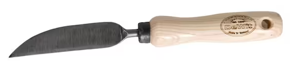

I wound up purchasing this DeWit Garden Knife to use instead. Haven't tried it yet.
grandpahack wrote: ↑Sun Jul 09, 2023 7:36 pmShort answer, no, I don't think a mule would be a great blade for your described task.
