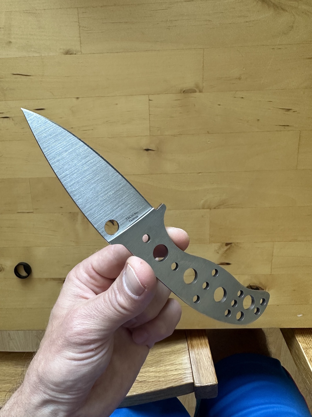

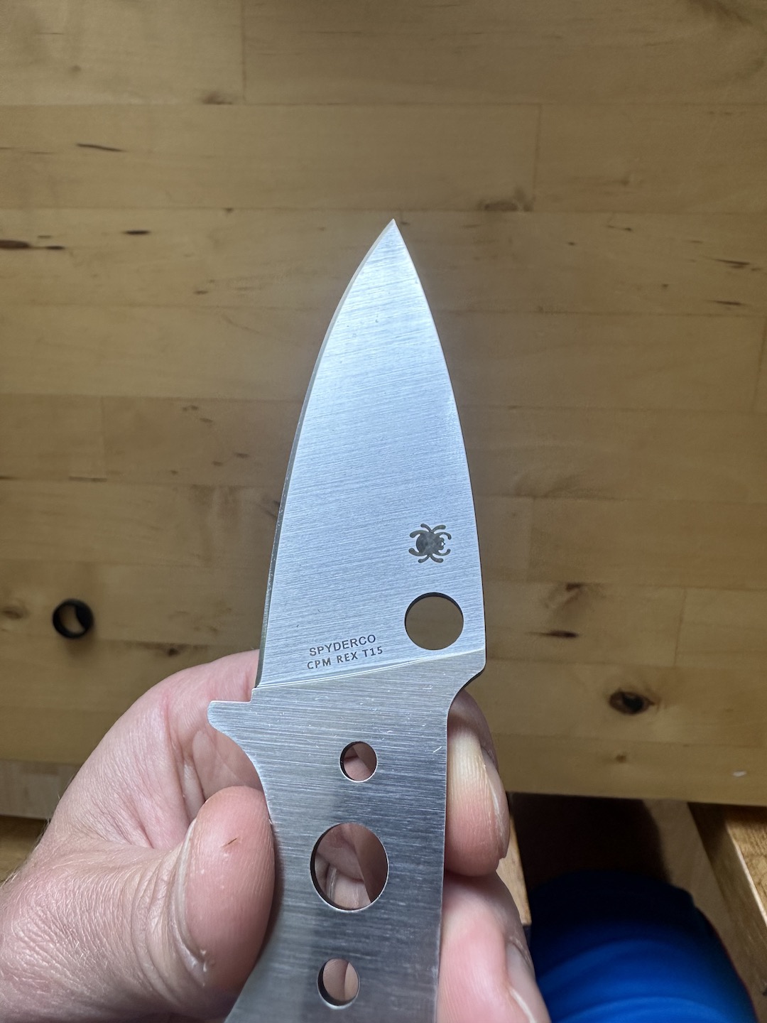

Whoa! It is stunning. Just wanted to post some pics of the T15 I received today because of how good it looks. I’m fairly confident this is the sharpest factory edge I have ever received, s-cuts printer paper smoothly in a way that it feels like it has been stropped. The primary grind has a cool facet-like reflection. Stoked.
