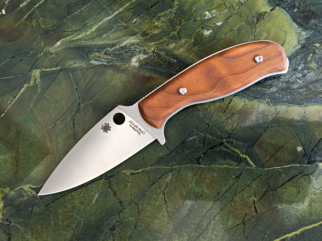

RustyIron wrote:
Fri Jun 02, 2023 8:48 am
The undersized scales are an intentional stylistic decision.
That's how I make my scales, too. I like the spine sticking out a bit. I think it gives me a better feel for the orientation of the knife. But I do chamfer the edges of the spine when I fit undersized scales, for comfort. (The angle of the camera makes it appear there's less spine at the top, but that's just wide-angle lens parallax.)

RustyIron
Posts: 3251
Location: La Habra, CA
Re: Handle and tang not flush?
Post by RustyIron »
Bolster wrote:
Fri Jun 09, 2023 5:42 pm
That looks gorgeous. I like the proportion. I'm not a fan of those commercial scales where you can't tell if they were trying for a perfect fit or an undersize fit. I've always made scales to fit, mainly because that's all that ever occurred to me, and more importantly, because it's easier. Making a perfect margin on all sides seems hard.
Posts: 6147
Thanks man! Regards:
RustyIron wrote:
Fri Jun 09, 2023 11:04 pm
...Making a perfect margin on all sides seems hard...
If it weren't for a bearing guided router bit, I'd agree. But with a BGRB, it's a cinch!
