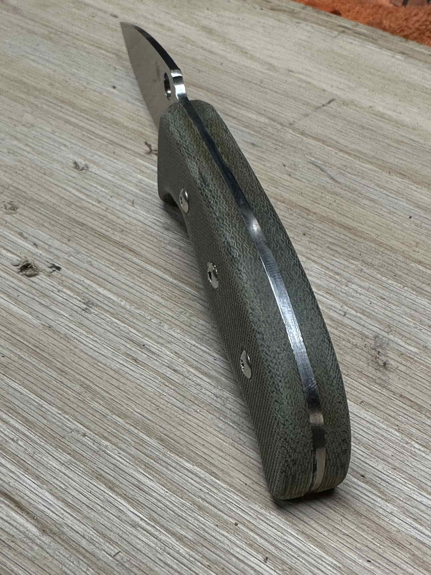

Well I tried my hand at making my own scales for the first time ever. Considering it was my first time ever and what I had to work with (no belt sander or anything you’d normally use) I’m pretty happy with the results.
I went to knife maker and bought the barrel spacers, hex head screws, a pair of OD green canvas micarta scale slabs and a pair of OD green with red liners G10 scale slabs.
I watched several YouTube videos and dos a lot of reading on here and other knife forums to get ideas and learn as much as I could. I decided to start with the micarta scales since they were the cheapest and they’re very easy to find. I did all this with a hand held jig saw, hand drill, angle grinder with flap discs, a palm sander and a little hand sanding.
I messed up a little bit right up at the lower guard area and I want to recess the screw heads more because I don’t like them being out past the scales. I’m also thinking about trying to contour them some instead of just being flat slabs but for now it feels very good in the hand (other than feeling the screw heads) and doesn’t look horrible. I think next weekend I’ll start on the G10 scales and a second set of scales for my awesome 15V mule.
The top picture was right after I finished up and the second picture was after a light coat of mineral oil.
