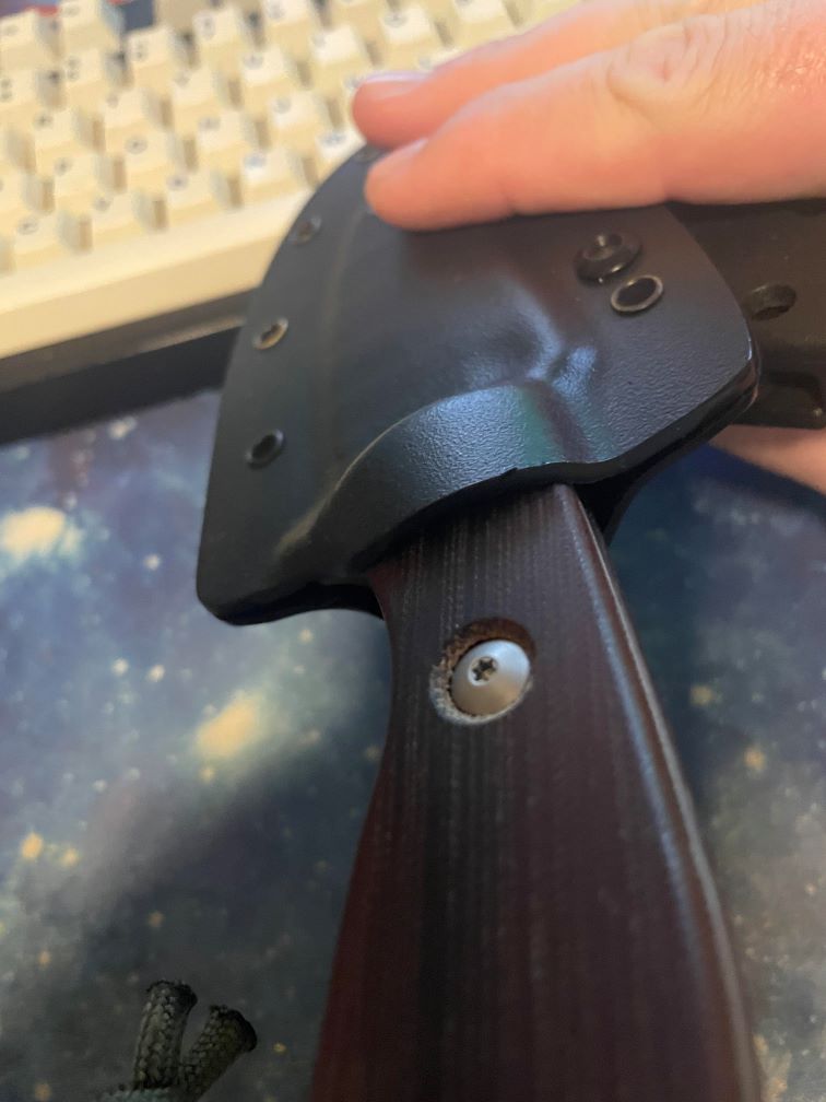

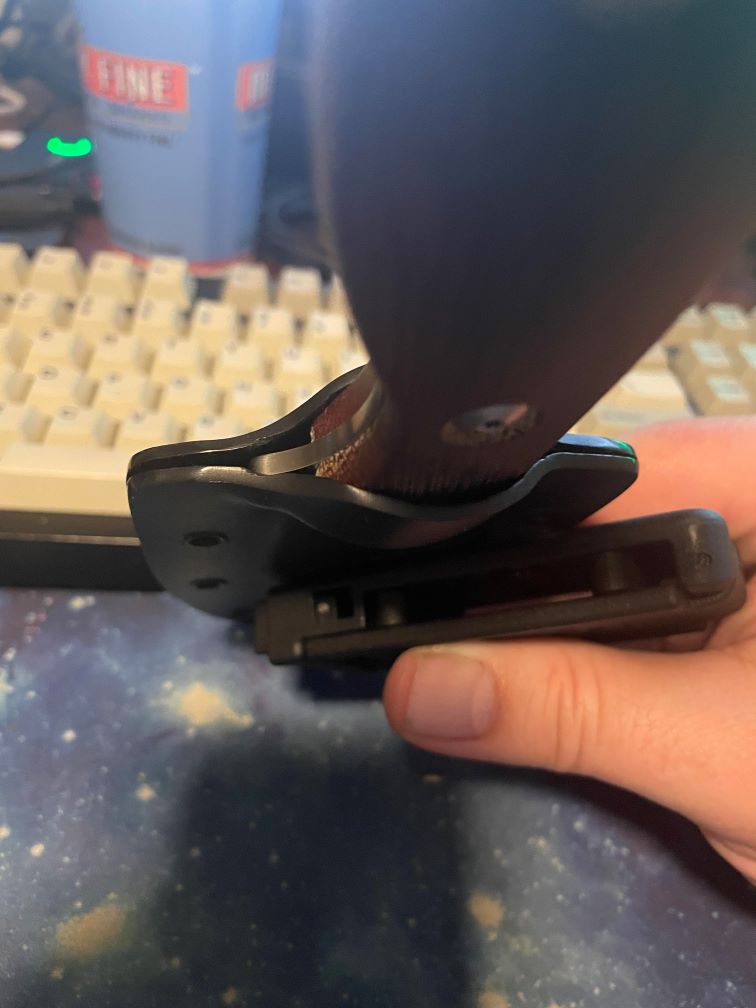

This has been my experience as well.
I may look into the Hazy scales for my second blade, which appear to use different holes but I’m not sure if anything other than he Halpern scales fit the kydex sheath sold by Spyderco.
I have Hazy scales with the Spyderco sheath. The retention is good enough for me, but the fit is probably sub-optimal. I have knife/sheath combos that have better retention and some that have lighter retention than this combo.
Thanks for posting. Good to know. I’ll look to give their scales a try and keep the kydex sheath.
