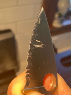

Yesterday I came across one of these stapled boxes...
And I wondered what would happen if I just didn't notice the staples and tried to cut the box open like normal so I went for it
At first I was really impressed with how the edge handled that, all I could see were some shiny spots along the edge. I didn't get a chance to try to take good clear shots until I got home.
Then I noticed this little fella
That one is going to take a few sharpenings to see it honed out but the rest of the edge sharpened back up like normal. I think that tooth chip is in part due to the fact that these serrations have not rounded off the same way other SE knives do, and I can only assume it just has to do with the geometry that they were ground at. I've sharpened this knife on my diamond rods several times now and the teeth are still quite sharp. Maybe they'd round off more if I used the 40 slots?
Regardless, MagnaCut is not impervious to damage, and in serrations I really don't think a steel exists that isn't but overall I'm very impressed with how well it handles abuse. I think overall the toughness is at least on par with H1 and LC200N if not better.

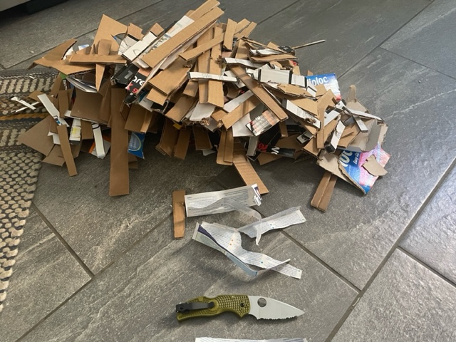

“Hunny I dulled the edge”
I estimate about 2000 inches of cardboard.
The edge was still able to cut through thin paper with no issue after cardboard cutting. The scallops have a little difficult, but nothing as noticeable and as fatigued and cramped as my wrist.
Choking up and putting all my weight on my thumb made this work much easier.

Kevinim82 wrote: ↑Tue Feb 21, 2023 9:37 am“Hunny I dulled the edge”
^^^ That’s the thing with the Natives ^^^
You can get way up on the blade and still have a safe grip. Same thing for the other grips. Great knife for getting stuff done.
