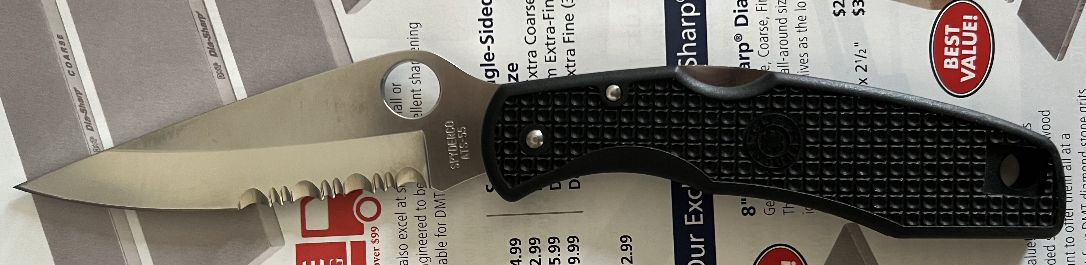

I’ve been really enjoying Native 5 lightweights for a smaller carry. Not having liners, the FRN seems harder then say a Stretch 2 in K390 (wish there were more no hump Stretch 2 models) which has liners. I really like the feel and look of the mold injected patterns done on all Spyderco. I have an Endura from the 90s, handles never cracked.
