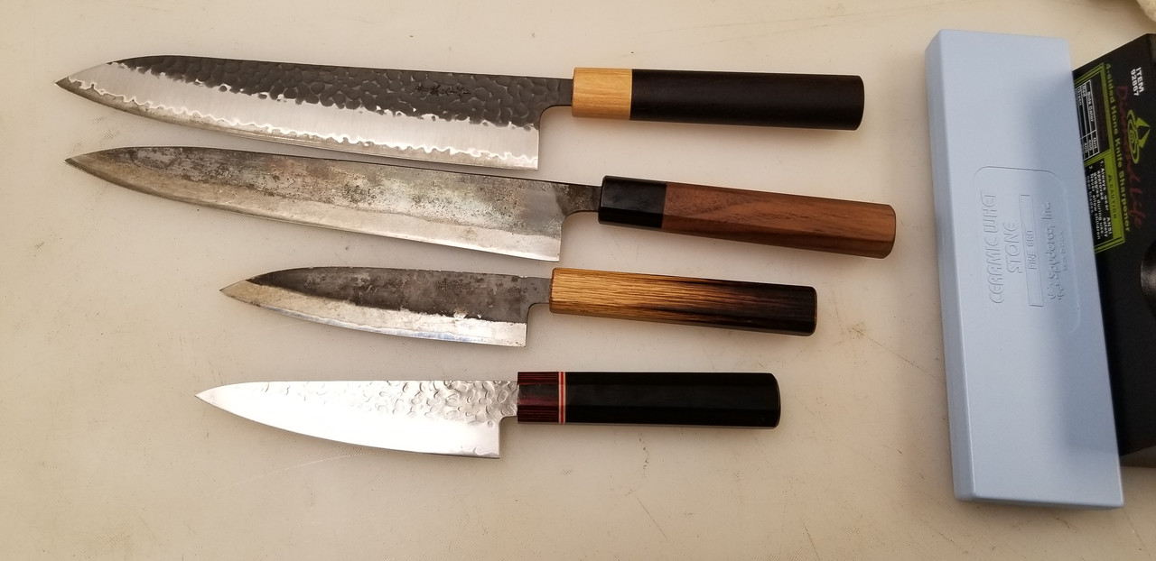

Sharpening day at work
Similar method as my pocket knives.
Reset the edge on 200 grit, refine all the way up to 300 grit until they roughly shave, then 1-2 strokes per side on the fine ceramic so they pop hairs.
The damascus one is VG10, the gyuto is Aogami Super, and the other two are white #1.
