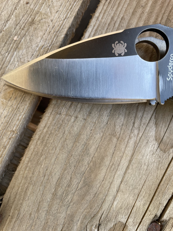

I guess it depends on what is a “full sharpening”.
Here is my two Manix I had at hand.
One is Maxamet and the other a reground 154CM hollow grind original that the earliest review I can find I did is dated 2012. It is a heavy user with my Gayle Bradley, Military, Atlantic Salt.
A broken tip, regrind and only a few millimetres off the blade. A “full sharpening” is done 3-4 times per week. That means 320 grit, strop and it shaves.
Either way. 11 years later and a few mm off the edge. Not bad IMO so maybe we are overthinking things.

Fireman
Posts: 2819
Re: Over sharpening?
Post by Fireman »
:winking-tongue Mule Team Army 001
MNOSD 008 :usflag
Image Stable Mules; Z-Max, Z-Wear, Magna Cut, SRS13, Rex 76, Rex T15.
Posts: 13216
#32
That knife is actually supposed to look like that. The Mosquito I believe it is?
