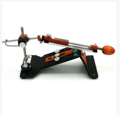

Hapstone makes a convex edge accessory

Re: Another Zoomer
KawRiverrat wrote: ↑Fri Mar 31, 2023 12:05 pmBolster, While I am familiar with Hapstone, this sharpner is new to me. While I enjoy sharpeneing by hand a tool like this
could be useful on heavy use knives that eventually need to thinned or reprofiled.
I think the "hinged guide rod" that would create an appleseed edge is an aftermarket accessory that could be used on any of the Hapstone sharpeners.
- Posts: 14
- Joined: Mon Mar 20, 2023 2:36 pm
Re: Another Zoomer
Bolster, here you go.
https://hapstone.pro/index.php?route=pr ... uct_id=289
Its appears to be a neat idea. I'd like to try it. After I have gained the capacity to do it by hand.
