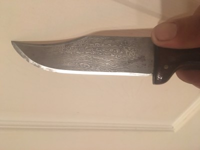

Check this out.
It was a convex grind but very dull and I honestly have no idea how to sharpen a convex grind. So I re-profiled the edge to 40°. It’s not perfect but you could shave with it.
Edit: Took about 2 1/2 hours to apex the edge with “The Beast”. By the way you are supposed to take it very easy with the 50 grit otherwise you’re just going to sheer off all the grit.
