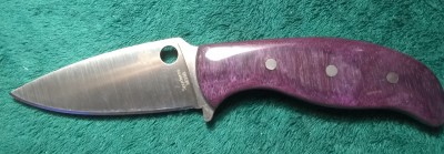

Post by Pacu0420 »
My M398 Mule with purple heart. I had finished the scales a couple months ago but they were a bit blocky and only sanded to 500 grit. I decided recently to thin the scales and give them more contour. I sanded the wood to 3000 grit then did 8 layers of clear coat. After that I sanded the last coat to 12000 grit. What a difference!

legOFwhat?
Posts: 3158
Location: Kentucky; Earth
Re: Show your Mule
#1691
Post by legOFwhat? »
Pacu0420 wrote:
Mon Mar 27, 2023 12:01 pm
That looks great!

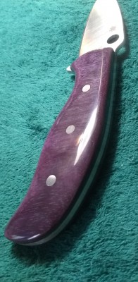

#1692
Post by Pacu0420 »
A couple more pics from a different angle.
