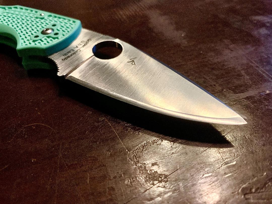

My only super blue knife is the black coated delica. I really want it to be a thin slicer but I am worried that if I put the edge back to 10dps then I will have a massive bevel that won’t look good with the TiCN coating. And then I can’t blend that bevel without removing the coating. Do I just need to buy the uncoated version? 😂
I am also wondering if you guys see the biggest benefit in performance by having a more acute edge bevel or by just getting it thin behind that edge. For example, if you had to choose one, would you rather have a 15dps edge that is crazy thin behind the edge (like a regrind) or a factory behind the edge thickness reprofiled to 10dps?

My recommendation: get an uncoated version (maybe even a second hand one) of a model with some 'normal steel' like VG10 or so, and take it to a water sharpening stone(s) and play with the edge geometry and see what you like. That is the best way to experience how different geometry will cut / behave. The actual number of of edge bevel, at the end of the day is just that - a number.

Big bevels looks fine with coated blades.
No need to blend them into the primary grind.
As to your second question, a very thinly ground knife with a tiny 15dps edge bevel will outcut a thickly ground knife with a 10dps bevel (like the Pacific Salt I posted). But it takes a lot more work and skill to properly do. I'm getting there with my sander but the type of edge I put on the pictured knife is good enough for a pocket knife for me.
Don't get me wrong, I love a knife with good geometry, but for breaking down boxes, opening packages and carving roasting sticks it's not the end all be all.
Now my work knives (chef).......that's where I start to really concern myself with geometry.

Matus and Vivi, thanks for your replies. I have an uncoated vg10 delica that I think I will work on first. I really like the black coating on the super blue delica so I'll leave it alone. I might knock the edge back a bit though. It just seems like a waste to have a 15-degree edge bevel on a steel like super blue.
And Vivi that is helpful feedback about geometry. I'll try manually regrinding the VG10 thin but with a 15-degree edge and see how it does. I do have an uncoated rex45 native that would be hard enough for very thin angles if I decide I love it. I'm sure that one would take more time to grind down than the VG10 though :woozy
