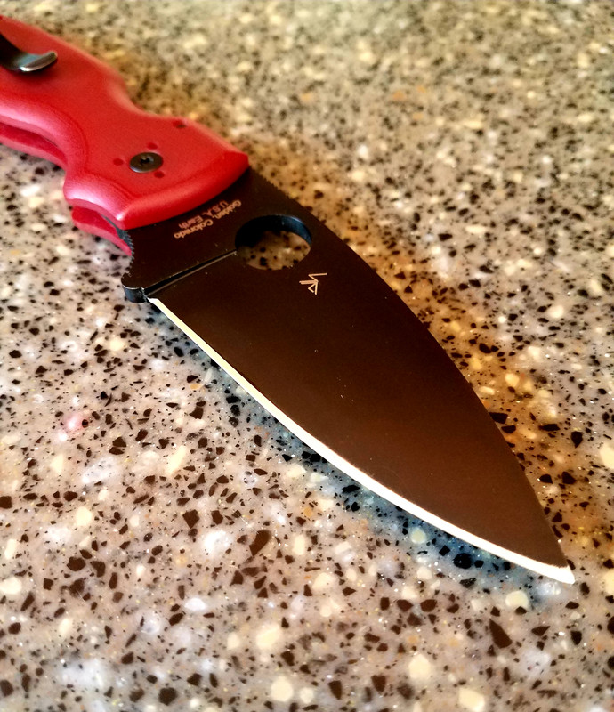

Finally finished this up last night after butchering the clip side edge while free handing on my DMT stones while watching football a couple weekends ago.
I decided to set it up on the Precision Adjust and went to work on the 320 grit at 15 dps. It took quite a while, as I'm sure that grit is no longer as coarse as it once was, but I was in no rush. I then decided to use the 600 grit option and gave each side 50 passes, lately I've stopped at the 320 grit, but wanted to switch things up little. I'm honestly not sure if those 50 passes even really made a difference. I then raised the angle to 16.5 degrees and give it a few passes, also something I don't normally do.
It's a very sharp and coarse edge, ready for battle!
Documented in my dorky spread sheet I've made for all my knives I've sharpened
