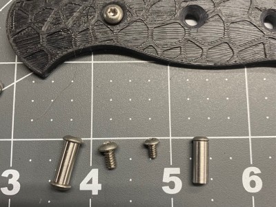

Connman
Posts: 11
Joined: Wed Jan 18, 2023 8:52 pm
Re: Mule Screws
Post by Connman »
My Halperns are 4-40 , 0.195 head diameter T8 , the other screw is a knife kit , 6-32 , .246 head T10
You can see how I countersunk scale for bigger screw.
The USA knife screw size is a catalog mistake , they use the 2-56 in their smaller pivot barrels , they use 4-40 in their 3/16 barrels.
