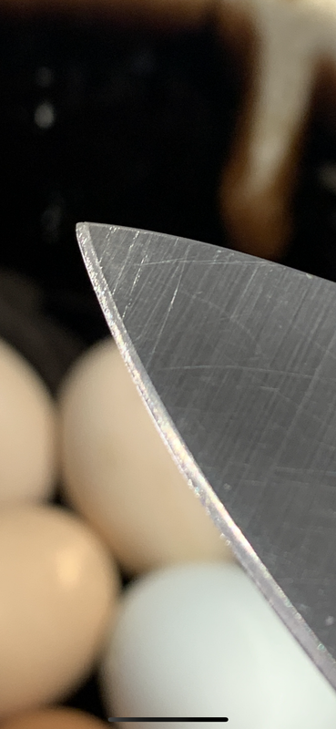

Posts: 5910
Re: Sharpening and bladeprotection.
apollo wrote:
Fri Feb 17, 2023 5:27 am
Guys just out of interest.
What do you all use to sharpen youre spydies?
And how do you protect you're blades from scratching them up while you are doing it?
Myself i mainly use the Sharpmaker along with the ken onion worksharp.
Now the sharpmaker it self is offcoarse easily used without any chance of scratching the blade. And its superb for keeping a knife perfectly sharp , But when i need to reprofile a knife i am sorry to say this Spyderco but it just isn't it for me. (Even have the diamond stones and even with those it feels like years before you are done)
So there for i bought the worksharp and the thing does an amazing job but allas its a tool that scratches up the blade if you are in a lazy mood and forget to tape up the entire blade.
So i wonder what do you guys use and do any of you have a better way to protect you're blades then taping the thing up all the time?
Not that i have something against scratches on the knives that i use but sharpening scratches anoy me more then those made by everyday use for some reason. :woozy
Apollo - you ain’t the only one…I scratched the sh.. outa my Caribbean’s tip section on it’s first sharpening🤬of course I was a total newbie and using the little Worksharp field sharpener…now I use the guided Worksharp system and still a total amateur but haven’t had that problem since…ordered a triangle SM yesterday now that I’m getting into serrations…I use the he.. outa my knives and not one is excused…new car syndrome only lasts a couple days then it’s off to the races…I do however understand not wanting to scratch a blade…i.e. a super expensive knife or sharpening someone else’s 🔽
Imagewhere's the closest
Caribbean-1st sharpening
Just got this yesterday afternoon 🤣
